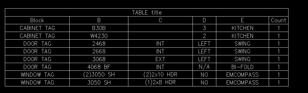

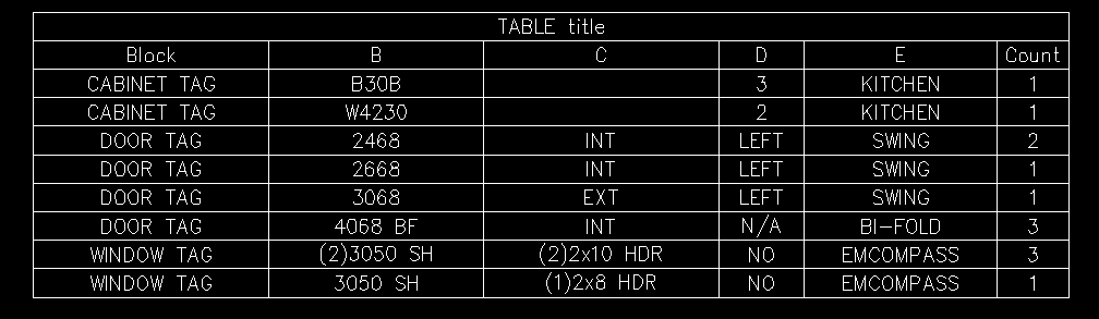

This is what I got as a result, the Door Tag block should count correct need to look more into block.
I added more blocks so can see count.
Edited by BIGAL
