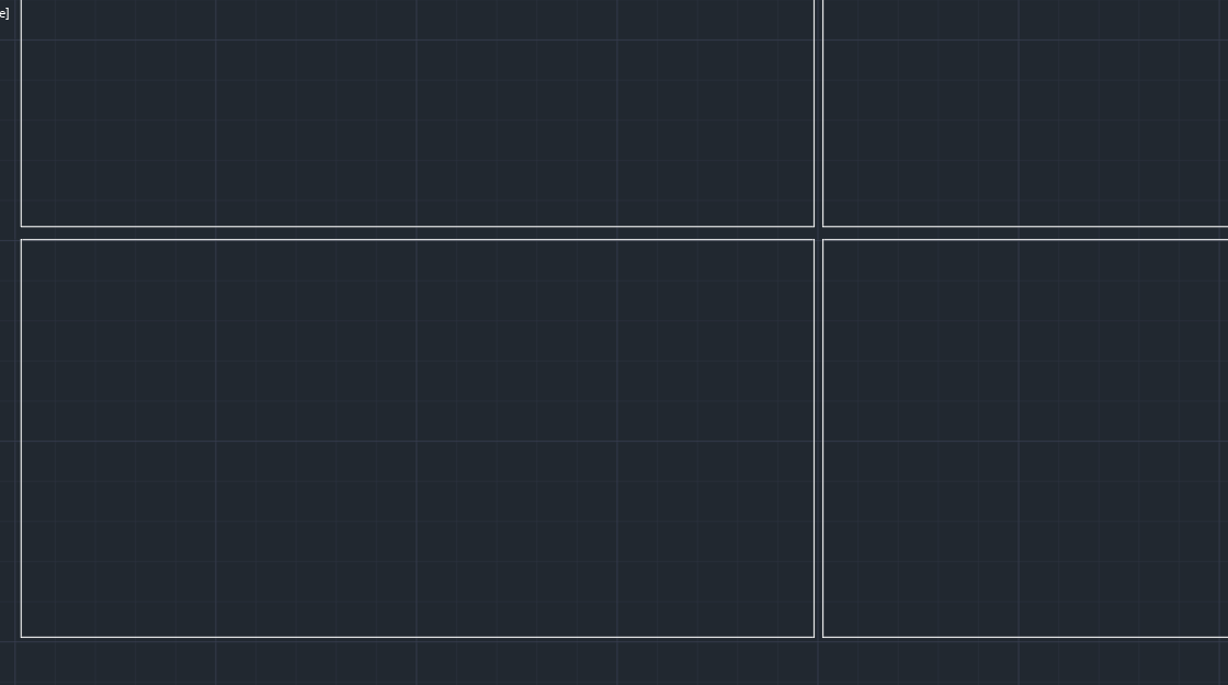

 I also attached pictures with an example of contour, block and how I want it to look at the end

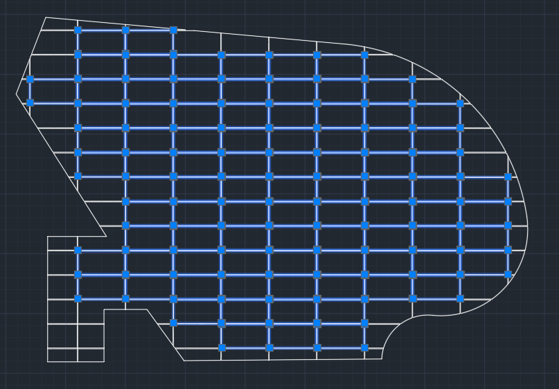

With a couple of mins was able to fit in 110 on the left 117 on the right with rotating the polyline

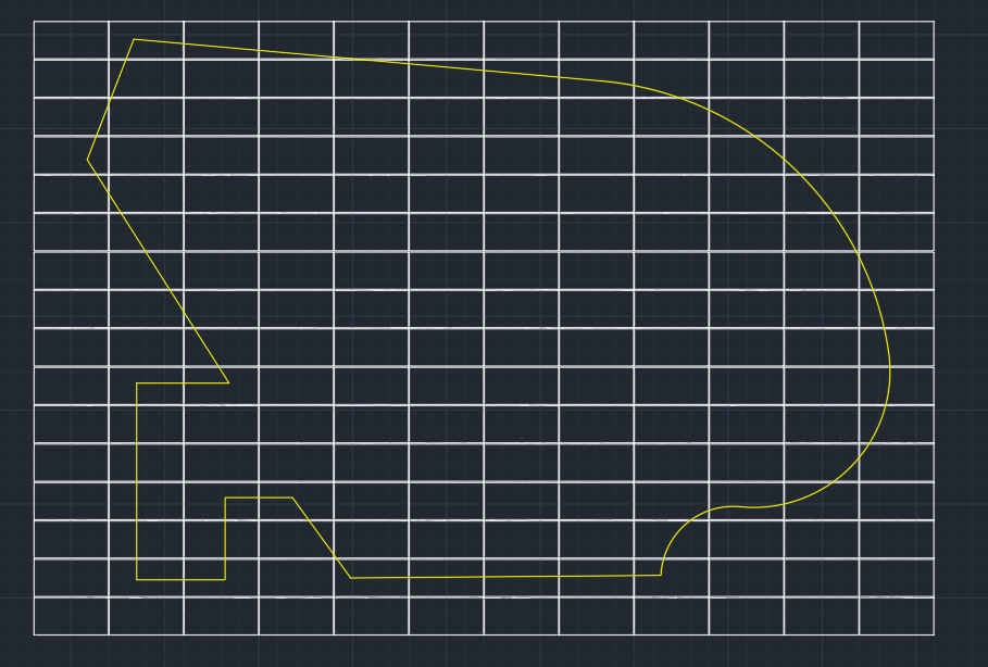

Here is my outline, converted to region too

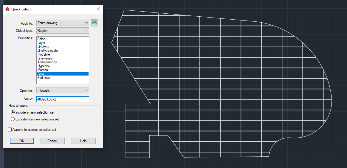

This is what quickselect returned
