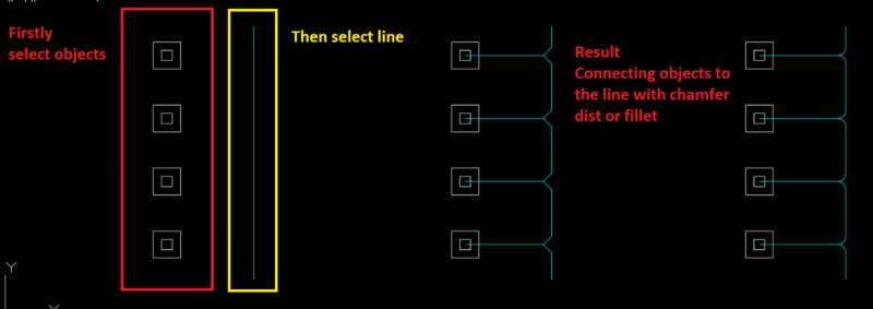

Hi everyone,
I want to connect the selected blocks to the line . I searched the forums but couldn't find the lisp I wanted.
https://forums.autodesk.com/t5/visual-lisp-autolisp-and-general/break-amp-fillet-amp-join-a-polyline-line/td-p/10707334
This lisp works with polylines and we always click blocks one by one.  It works fine, but I draw with lines(not polyline) and I need to select many blocks at once.
Do you know a lisp like the one in the screenshot?  Or can someone help?

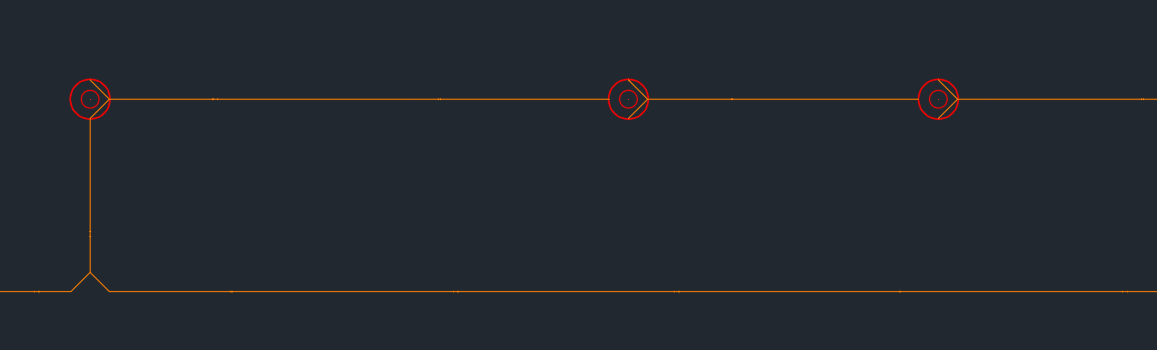

@Steven P my lisp skills are bad.  I looked at the pedit command as you said.  I tried with examples but I could only draw a line between the block and the line.

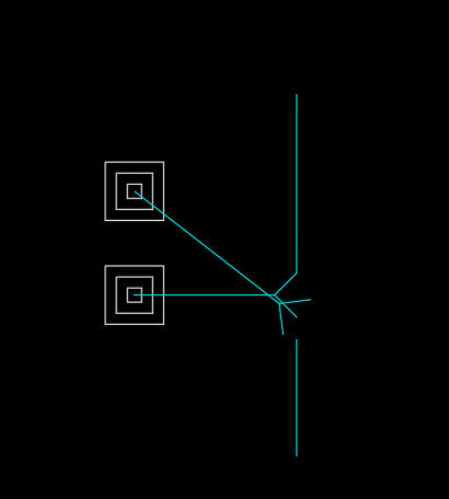

@mhupp thank you for the code but when i try the code all blocks try to connect to the same point.
This is how it should work. The trim command in Bricscad the starting point of the line has to be on top. I guess in AutoCAD its reversed.
updated code  or re select above code.

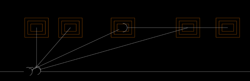

Also if blocks are closer then r vertically this is what will happen.

Thank you.  I tried the code now but still the same problem repeats.
lol didn't account for horizontal in the if statement works now.

I ran into a problem today. During the process, there is no problem in the lower horizontal, but it makes a connection error in the upper horizontal.
@ronjonpI use wipeout inside blocks when drawing. But I do a lot of editing on the connection points while drawing, I need to design a new block for each connection shape and I always have to keep these blocks. If I lose blocks it takes time to recreate.
Seems the if statement is a little to pierces checking all 15 digits of the X of each point. upgraded it to a conditional with a fuzz distance check. this should fix all the problems now.
Fixed horizontal link upwards error, but now gives this error with 10-15% chance both horizontally and vertically.
