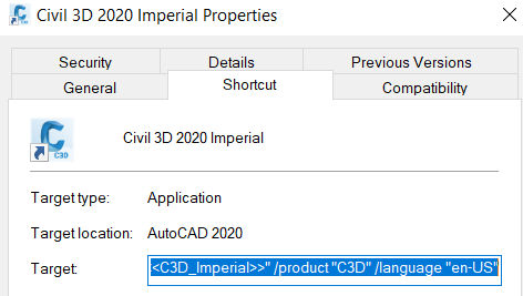

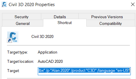

BIGAL Posted July 16, 2022 Posted July 16, 2022 (edited) Profiles are saved under Options, so the architecture may have a profile already, you copy a icon on the desktop and right button click then look at properties, you change 2 things the description in General and the profile. The 1st image is a saved profile, second image is a default imperial CIV3D. Edited July 16, 2022 by BIGAL Quote
