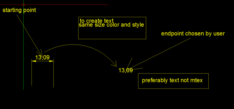

help with extracting text from one dimension....
hello :
I had a routine that did this but I lost it  :(
1.- I need to select a dimension
2.- then a text will be created with the style and size of the selected dimension
3.- that text will move from the center point to where the user determines
like exploding the dimension and moving the text to another place but not exploding it
test.dwgFetching info...

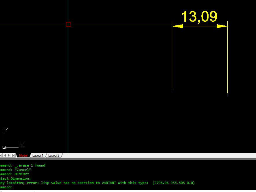

I MODIFIED AND IT STILL DOESN'T WORK FRIEND   :(
image.png.ae6d69bbb111b07ed5cdc49032ea0ac5.pngimage.thumb.png.b9681d5051972059c02182533a588ba8.png
can you upload a sample drawing with one dim so i can test?

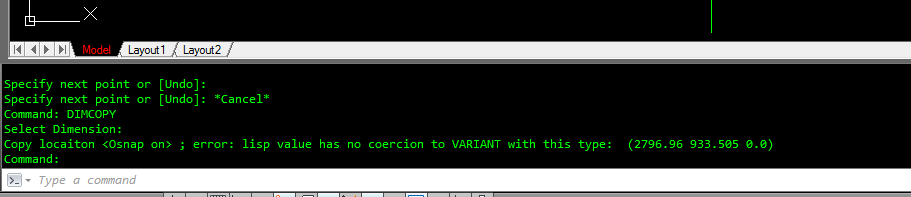

Likewise I am getting an error - is it a BricsCAD / AutoCAD thing maybe with the line
    (vla-move copy BP (getpoint "\nCopy locaiton"))
which is where it stops and comes up with the error
"Copy locaiton; error: lisp value has no coercion to VARIANT with this type:"
I haven't looked to see why it is doing that though
no idea why its working for me and not you guys. took out the vla-copy and just use command
--edit
