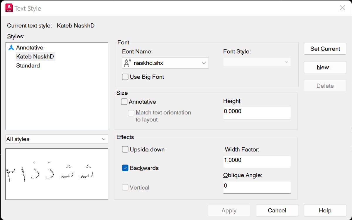

mr_bin47 Posted July 6, 2022 Share Posted July 6, 2022 hi friends, I'm using autocad with just many fonts, these fonts are very popular fonts on company so for every file i should to Refine these Text Style, is there any way with lisp program that i place on autocad to know these Text Style for every time and can be use on every file ? Special thanks Hamid Quote Link to comment Share on other sites More sharing options...
mhupp Posted July 6, 2022 Share Posted July 6, 2022 (edited) This matches above. yes is for the backwards being checked. change to "" if not needed to be backwards (vl-cmdf "_.Style" "Kateb NaskhD" "naskhd" "" "" "" "Yes" "" "") Add to a lisp that is in your startup suite at is loaded on load. Edited July 6, 2022 by mhupp 3 Quote Link to comment Share on other sites More sharing options...
mr_bin47 Posted July 6, 2022 Author Share Posted July 6, 2022 20 minutes ago, mhupp said: This matches above. yes is for the backwards being checked. change to "" if not needed to be backwards (vl-cmdf "_.Style" "Kateb NaskhD" "naskhd" "" "" "" "Yes" "" "") Add to a lisp that is in your startup suite at is loaded on load. thank you sir, as i'm new to this, can you help me to what to do with this LISP, copy and paste on which file ? Quote Link to comment Share on other sites More sharing options...
mhupp Posted July 6, 2022 Share Posted July 6, 2022 Type appload this should pop up load style.lsp into the startup suit. contains above code. style.lsp 2 Quote Link to comment Share on other sites More sharing options...

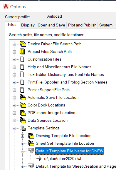

BIGAL Posted July 6, 2022 Share Posted July 6, 2022 The best way is to use a template drawing a DWT. You have a blank dwg with all your text styles, dimension styles, blocks, layers and more all preset then save as a dwt. You can set every time you start cad your dwt is the default, same if you type NEW. Just type Option 2 Quote Link to comment Share on other sites More sharing options...
mr_bin47 Posted July 7, 2022 Author Share Posted July 7, 2022 8 hours ago, BIGAL said: The best way is to use a template drawing a DWT. You have a blank dwg with all your text styles, dimension styles, blocks, layers and more all preset then save as a dwt. You can set every time you start cad your dwt is the default, same if you type NEW. Just type Option that's a good way , thank you sir Quote Link to comment Share on other sites More sharing options...
