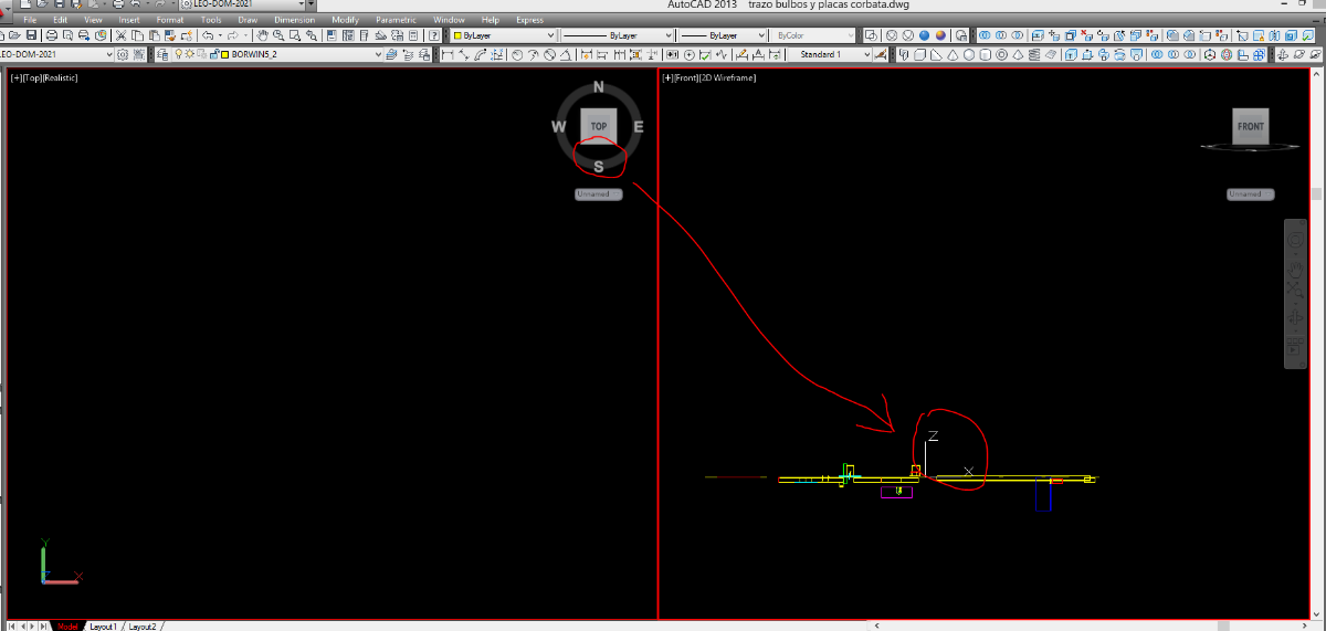

leonucadomi Posted July 4, 2022 Posted July 4, 2022 I WOULD LIKE TO KNOW IF THERE IS ANY VARIABLE OR COMMAND TO CHANGE THE UCS WHEN I SELECT A FACE ON THE CUBE. AND NOT HAVE TO BE RUNNING UCS COMMAND...AND VIEWPORT OPTION THANKS Quote
BIGAL Posted July 5, 2022 Posted July 5, 2022 May be a solution, no need for viewport or UCS you can use vpoint in particular say -vpoint 1,1,1 is a 3d view changing the x,y,z value to zero can give quick access to a square off elevation. Then UCS V or UCS OB. (if (= look "R")(command-s "-vpoint" "1,0,0")) (if (= look "L")(command-s "-vpoint" "-1,0,0")) (if (= look "F")(command-s "-vpoint" "0,-1,0")) (if (= look "B")(command-s "-vpoint" "0,1,0")) (if (= look "P")(command-s "-vpoint" "0,0,1")) Quote
