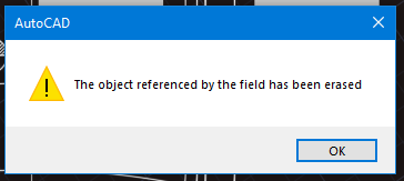

phjlc Posted July 4, 2022 Share Posted July 4, 2022 Hello, I really dont know if this is the appropriate board to post this, but Im having an issue regarding to my Dynamic block losing its field everytime I save, it is showing this error I always need to run this after i open (defun c:asd () (setq ssblck (ssget "x" (list '(0 . "INSERT"))) lpdtct 0 ) (repeat (sslength ssblck) (if (not (eq (vlax-get-property (vlax-ename->vla-object (ssname ssblck lpdtct)) 'effectivename ) "OIS-LVL-BLK" ) ) (progn (setq lpdtct (+ lpdtct 1))) (progn (SETQ d1 (ssname ssblck lpdtct) d2 (vlax-ename->vla-object d1) d3 (itoa (vla-get-objectid d2)) d4 (vlax-invoke d2 'getattributes) d5 (car d4) ;ffl d6 (cadr d4) ;lvl d7 (vlax-variant-value (vlax-get-property (nth 4 (vlax-invoke d2 'getdynamicblockproperties)) 'value ) ) ) (if (eq d7 1) (progn (command "move" d1 "" '(0 0 0) '(0 1212 0)) (setq lpdtct (+ lpdtct 1)) ) (progn (vlax-put-property d6 'textstring (strcat "+" "%<\\AcObjProp Object(%<\\_ObjId " d3 ">%).InsertionPoint \\f " "\"%lu2%pt4%pr3" "\">%" ) ) (vlax-put-property d5 'textstring (strcat "%<\\AcObjProp Object(%<\\_ObjId " d3 ">%).Layer \\f " "\"%tc1" "\">%" ) ) (setq lpdtct (+ lpdtct 1)) ) ) ) ) ) ) Thank you for anyone who will response. Quote Link to comment Share on other sites More sharing options...
BIGAL Posted July 5, 2022 Share Posted July 5, 2022 (edited) Sometimes with this type of thing insert the block and as a second step up date it, so you would use (entlast) to get object then put dynamic properties. I know that for blocks must get the id every time as it must reflect the inserted block. You can not copy the block if you have set a ID. Why dynamic block does it do something special ? Where are the values coming from? You may need to post a real dwg. Edited July 5, 2022 by BIGAL 1 Quote Link to comment Share on other sites More sharing options...
