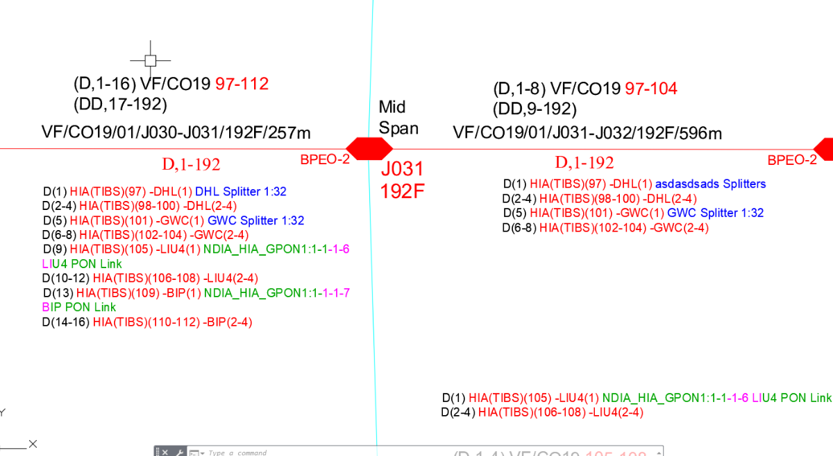

HELP : I need a LISP Routing That can help me find a specific text within multiple Mtext and change their color
I have multiple Mtext in a scehmatic Drawing , containing text
The blue color in the this text box indicated planned state ,so once this particular link is commissioned i will be changing it to green
QDC(55-56)-LZS[192F](19-20) Reserved for Bu samdra WDM Connectivity
This specfic text is duplicating in aroung 20 to 30 M texts ,i want a routing that can automate this manual work
Any help would be greatly appreciated

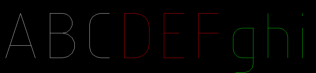

If you look at this
The text string is "ABC{\\C1;DEF\\C3;ghi}\\P" so can see color string
This is very rough and needs more error checking but as a 1st go, enter color number of existing mtext then new color. If it works doing manually then can add the multiple option. Really need a true dwg to check properly.

Hi steven , iam not very adept to LISP code writing  but as i understand my requirement is not to look for the colour change postion ,instead i want to be  able to match a text that i input myself and then i want to be able to change it's color ,regardless of where it lies in the M text.
I usally use find and replace to change the content of the text all the time and then manually go to all the mexts and change the color of the text.
examply in the snapshot above ,
Reserved for madinata compound ,once this link is Ready for service i will find and replace this specific text to for example " NDIA_GPON1_1-1-1-8"  and for this specific text i want the color to be Green instead of blue .
i just want the default find and replace functionality which instead of replace the text can replace the color of the text.

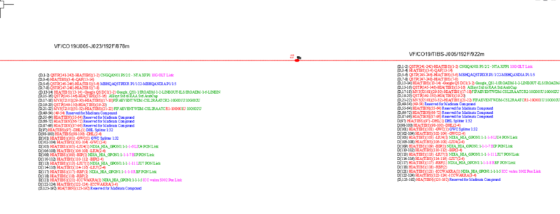

I have added a portion of my drawing , i tried txt replace function and it didn't change any text in this drawing.
you can also try changing (Reserved for Madinata Compound) with (NDIA-GPON1-1-1-1) with a change of color to green \C92
i saw the contents and yes your right ,the formatting data is embedded in it.
TEST.dwg
Just an update , the test replace did work ,but not on all the mtext ,I just used the textreplacefunc in you LISP.
My in input was
OLD text:DHL Splitter 1:32
New Text:asdasdsads Splitters
Ideally it should have changed all the texts
Thanks for the test drawing and I can see the problem.... err thanks I think because the replace function needs a little reworking that I have never noticed before.
So in technical things, every object you draw is an entity and all the parameters for that are contained in an entity description - the entget I mentioned above refers to that. I think each entry into that definition can be about 250 characters long, not normally a problem with annotating a drawing., but with long mtext you get an overspill to another part of the entity description, and you need to pick that up too for the text replace. That's what needs doing in the function above, to add in these other codes so it looks at all the text.
Anyway, thanks, I was hoping for a nice easy answer "here, try this" and you come back with a simple "can you make it do that" and off you go happy..... but no, needs a bit more work...
On the positive side though, the shorter texts and I think it works as you want, you can set it to change text and change colours as you want
