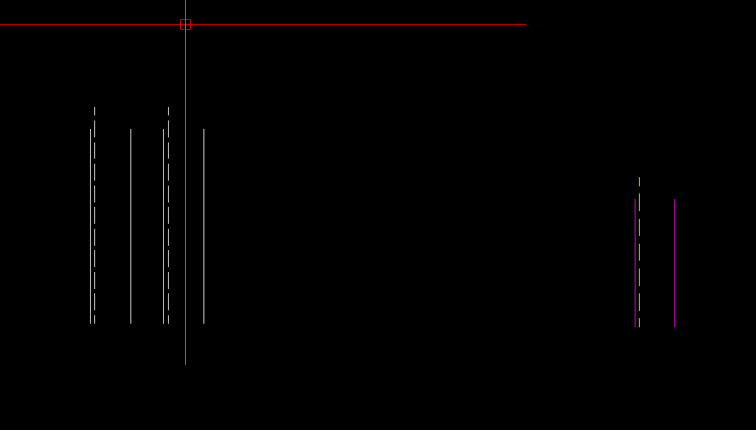

leonucadomi Posted June 28, 2022 Posted June 28, 2022 hello people: I want to make a selection in the window of the white lines. then the lines in continuous line white that take the properties of the magenta line and the dashed lines white take the properties of the yellow line . all in one move it's possible? pru.dwg Quote
leonucadomi Posted June 28, 2022 Author Posted June 28, 2022 I want it to do it automatically without using quick selection... Quote
BIGAL Posted June 29, 2022 Posted June 29, 2022 If you use (ssget "F" as in fence filter this allows you to drag a dummy line over say the 3 lines then repeat, with out going into it to deep then check the pick order of 1st selection, then change the second selection. The reason you need to check the order is ssget can retrieve in drawn order so middle line may be 3rd object not second. Have something using this method will try to find. Some one else jump in while I try to find. Quote
