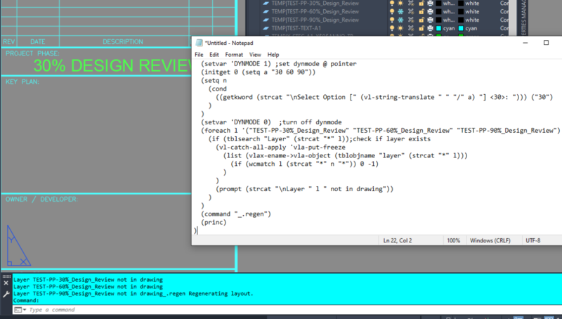

CAD_Noob Posted June 29, 2022 Author Share Posted June 29, 2022 5 hours ago, ronjonp said: Here's another way to do it with very little error checking. (defun c:foo (/ n) (or (setq n (getint "\nEnter percent:<30>")) (setq n 30)) (foreach l '("TEST-PP-30%_Design_Review" "TEST-PP-60%_Design_Review" "TEST-PP-90%_Design_Review") (vl-catch-all-apply 'vla-put-freeze (list (vlax-ename->vla-object (tblobjname "layer" l)) (if (wcmatch l (strcat "*" (itoa n) "*")) 0 -1 ) ) ) ) (princ) ) Thank you very much! It's working find. If I need to add more options can i just add it to the "for each "list? One thing that's not working is that if say all are thawed / on and I press 60, it works but if I press 30, 60 will be frozen and nothing is shown anymore. Quote Link to comment Share on other sites More sharing options...

ronjonp Posted June 30, 2022 Share Posted June 30, 2022 1 hour ago, CAD_Noob said: Thank you very much! It's working find. If I need to add more options can i just add it to the "for each "list? One thing that's not working is that if say all are thawed / on and I press 60, it works but if I press 30, 60 will be frozen and nothing is shown anymore. Try a regen. 1 Quote Link to comment Share on other sites More sharing options...
CAD_Noob Posted June 30, 2022 Author Share Posted June 30, 2022 14 minutes ago, ronjonp said: Try a regen. Thanks. regen works. Can i insert the regen in the code? Quote Link to comment Share on other sites More sharing options...
ronjonp Posted June 30, 2022 Share Posted June 30, 2022 50 minutes ago, CAD_Noob said: Thanks. regen works. Can i insert the regen in the code? (command "_.regen") 1 Quote Link to comment Share on other sites More sharing options...
CAD_Noob Posted June 30, 2022 Author Share Posted June 30, 2022 (edited) 27 minutes ago, ronjonp said: (command "_.regen") like this? (defun c:foo (/ n) ;;(or (setq n (getint "\nEnter percent:<30>")) (setq n 30)) (if (not AH:Butts)(load "Multi Radio buttons.lsp")) (or (setq n (atoi (ah:butts 1 "h" '("Choose revision" "30%" "60%" "90%"))))) (foreach l '("TEST-PP-30%_Design_Review" "TEST-PP-60%_Design_Review" "TEST-PP-90%_Design_Review") (vl-catch-all-apply 'vla-put-freeze (list (vlax-ename->vla-object (tblobjname "layer" l)) (if (wcmatch l (strcat "*" (itoa n) "*")) 0 -1 ) ) ) ) (command "_.regen") (princ) ) can i add more option in the foreach list? Edited June 30, 2022 by CAD_Noob Quote Link to comment Share on other sites More sharing options...
mhupp Posted June 30, 2022 Share Posted June 30, 2022 44 minutes ago, CAD_Noob said: can i add more option in the foreach list? Of course, but you would have to add it to the "Choose revision" list also. (or (setq n (atoi (ah:butts 1 "h" '("Choose revision" "30%" "60%" "90%" "Finished"))))) (foreach l '("TEST-PP-30%_Design_Review" "TEST-PP-60%_Design_Review" "TEST-PP-90%_Design_Review" "TEST-PP-Finished_Design") Basically what you choose has to be in the layer name for this lisp to work properly 1 Quote Link to comment Share on other sites More sharing options...
