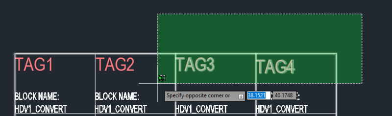

Hello everyone,
I would like to select multiple attributes in one area (example: (ssget "_:L") and automatically select all duplicate tags based on the selected attributes.
can you give me some help?
Reference: https://forums.autodesk.com/t5/visual-lisp-autolisp-and-general/selecting-a-block-by-its-attribute-value/td-p/2195298

Your idea is very interesting, I'm looking for a way to multiple selections. click and drag type.

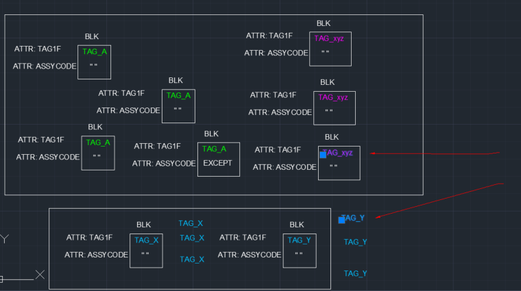

Gentlemen, I appreciate your support. I'm sorry for the basic doubts I'm still a beginner.
The first script worked perfectly but with the single click at a time.
In the second script I can not select anything.
FInd attached the DWG file.
If possible I would like to choose the attribute for the selection: example TAG1F, DESC2, DESC3 etc...

@BIGAL@mhupp
Thank you so much for your support.
In this example I include the match attribute manually.
This would be perfect if it were possible to take the list of previously selected attributes and include them a variable tag1.
