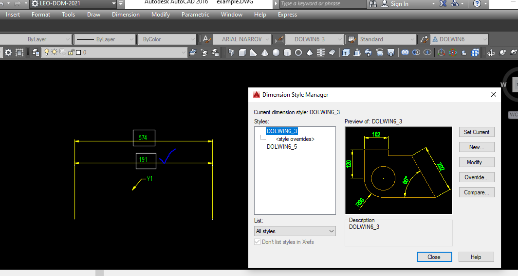

I have two styles of dimensions from a file sent to me:
DOLWIN6_3
DOLWIN6_5
The problem is that I position myself in either of the two dimensioning styles and the new dimension that I generate gives me a scaled value.
How can I draw scaled dimensions?
example.DWG
The dimension that you have generated is the actual distance.
Dimension Style DOWLIN6_3 has a scale factor of 3, and Dimension Style DOWLIN6_5 has a scale factor of 5.
look at this file please
the dimension in white rectangle is scaled
what I want is to make dimensions like this scaled
I'm in DOWLIN6_3 AND A NEW STYLE IS GENERATED
example2.DWG

The 574 dimension has scale overrides.
Pick the 574 dimension and right-click then pick "Dim Style" then pick "Save as new style…" and give it a name.
Now that it's a dimension style you can use it to draw other dimensions in the same style.
Like eldon I prefer everything drawn true size but there are some exceptions to every rule. I've created a lot of typicals and details in Paper Space which required me to use dimensions with scale values. Once they're complete I use Lee Mac's
to fix the values so they'll display correct values even if they were scaled to plot at a different size.
