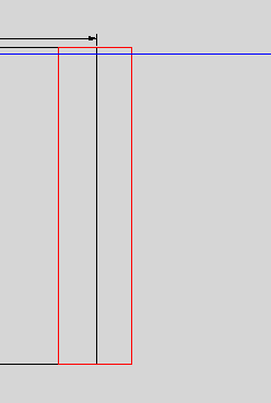

Looking to draw a rectangle similar to a rich line. Where I can click 2 points and draw a rectangle through the centerline.
I use mostly 2 widths so the rectangle width would would be predetermined in the lisp routine. I will create a button to initiate the routine.
Thanks in advance
Tom
Yeah, sure.
Command TCCR.
I let you first enter the width.
Then, since you need that width multiple times I put the rest in a while loop.
Of course you can hard code the width and remove the while if you want.

Works perfect thanks!
Good idea to specify the width first, I didn't think about that.
Thanks Again
Tom

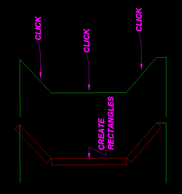

Is there a way to modify the TCOR so I can select one edge of a Polyline?
I'm thinking that pt1 and pt2 could be used from the selected polylines edge.
The polyline will always be closed and the offset rectangle will need to go to the inside of the shape.
I tried a couple of things but don't know how to isolate just one line from the polyline.
Thanks!

What I would like to do is just click one of the polylines segments and then offset a given distance to the inside of the shape.
And yes, those points will be 2 consecutives points on the polyline.

I need to create a rectangle from the selected polyline segment.
Sorry if I wasn't clear. The above routine (TCOR) asks me what width the rectangle is, then I pick 2 points and it draws the rectangle from that width and from one point to another.
What I need is to be able to just select a polyline segment and create that rectangle.

Do you mean to draw a rectangle "centered" on the pline side?
Some like it?
You need get segment of pline, and  a check of direction CW or CCW.
