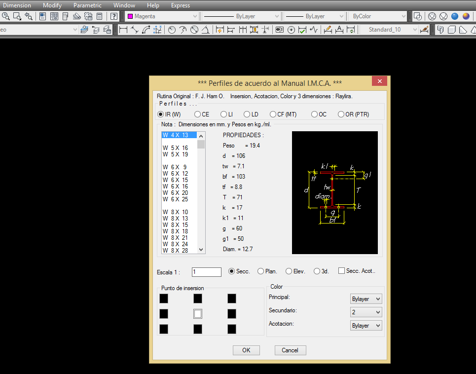

leonucadomi Posted June 22, 2022 Share Posted June 22, 2022 hello people... Does anyone know of a routine to draw European structural profiles? Quote Link to comment Share on other sites More sharing options...
Steven P Posted June 22, 2022 Share Posted June 22, 2022 You might need some context as to what kind of profiles you are looking for? Is this steelwork, concrete, roads....? Quote Link to comment Share on other sites More sharing options...
leonucadomi Posted June 22, 2022 Author Share Posted June 22, 2022 something similar to this... is an autocad application that draws metal profiles based on the Mexican steel construction code Quote Link to comment Share on other sites More sharing options...
exceed Posted June 23, 2022 Share Posted June 23, 2022 https://blog.draftsperson.net/wiseys-steel-shapes-lisp-program/ Wisey’s Steel Shapes.zip Revision H like this? maybe have to add EU profile 2 Quote Link to comment Share on other sites More sharing options...
BIGAL Posted June 23, 2022 Share Posted June 23, 2022 Agree with exceed it has many shapes you have to look in the data files they are text files, so could make your own. I am sure have seen way more shape files. Mexican may use USA. Quote Link to comment Share on other sites More sharing options...
