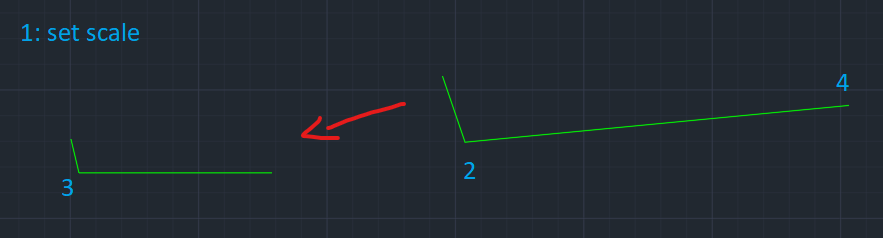

mousho Posted June 20, 2022 Share Posted June 20, 2022 Hi friends i Need help to copy Pline, scale it and draw it in new place if the long line will align with plan X it be great i search the web with no success Quote Link to comment Share on other sites More sharing options...
Emmanuel Delay Posted June 20, 2022 Share Posted June 20, 2022 (edited) I based this on somebody's code that combines a copy with align. Link in the code. Command SCS (for Copy Scale) - set scale. - select polyline. (if you want it will permit you to select multiple objects) Then select 3 points (see attached picture) - point 2 is the source base. - point 3 is the base point of the destination. - point 4. that's the end of your long line. It will be set horizontal on the destination. The distance of that long line will be used to calculate the scale of the pasted object. ;; based on c:COPYALIGN ;; https://forums.autodesk.com/t5/visual-lisp-autolisp-and-general/combining-copy-amp-align-command/m-p/800575/highlight/true#M26233 ;; ;; Copy SCale (defun c:CSC (/ sc sSet P11 P12 P21 P22 1st 2nd) (setq sc (getreal "\Set scale factor: ")) ;;Combines COPY and ALIGN commands ;;by Jim Smith 2002 (or(member "geom3d.arx" (arx))(arxload "geom3d" nil)) (command "_.undo" "_be") (setq sSet (ssget)) (if sSet (progn (setq P11 (getpoint "Specify first source point: ") P12 (getpoint P11 "\nSpecify first desintation point: ") 1st (cons 256 (list P11 P12)) ) (grvecs 1st) (setq P21 (getpoint "\nSpecify second source point: ") ;; now we calculate P22. P22 is horizontal to the right of P12. ;; how much to the right? distance of P11-P21 X the scale factor ;; (polar pt ang dist) P22 (polar P12 0.0 (* sc (distance P11 P21))) 2nd (cons 256 (list P21 P22)) ) (grvecs 2nd) (command "_.COPY" sSet "" "0,0,0" "@") (align sSet P11 P12 P21 P22 "" "Y") ) ) (setq sSet nil) (grvecs (list P11 P12)) (grvecs (list P21 P22)) (command "_.undo" "_e") (princ) ) Edited June 20, 2022 by Emmanuel Delay 1 Quote Link to comment Share on other sites More sharing options...
