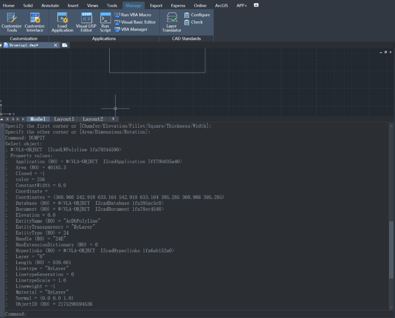

Its been a while since I played with ZWCAD. Does Zwcad support VL if so opens a world of code that will overwhelm you. Jump over comes to mind in electrical, showing cables crossing.
Try this lisp pick an object you should see all the properties when you pick an object.

Yes! I copied the code, created a script file, and loaded it in ZWCAD.
It works perfectly in ZWCAD as well! Check out the attched screenshot.
Good to see, Google your next question about a customisation your looking for.
