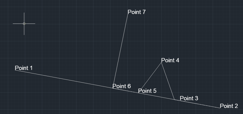

pietrow Posted June 10, 2022 Share Posted June 10, 2022 Hi everyone, i need help (a chunck of code) for checking if selected polyline is returning. In the picture belowe i draw a polyline with some point - vertex of polyline are in the base points of the text. In this case there is one point where the polyline is returning and this point is point 2. So in this case i want to get variable with value 1. Is there possibilty to do that? Thanks in advance Quote Link to comment Share on other sites More sharing options...
mhupp Posted June 10, 2022 Share Posted June 10, 2022 (edited) I guess you could make a temp copy of the polyline to explode and overkill. Check the total length of entity's left against the length of the unexploded polyline. original length = non returning length original length > returning length -edit You would then even know for what length its overlapping. -edit added lisp : RETURN Select entities: Polyline has 113.886 of overlap : RETURN Select entities: Polyline does not overlap ;;----------------------------------------------------------------------------;; ;; Check if a polyline is overlapping (defun C:RETURN (/ len len+ ss ss1 ent objs LastEnt) (setq len 0.0 len+ 0.0 ss (ssadd) ) (if (setq ss1 (ssget "_+.:E:S" '((0 . "*POLYLINE")))) (progn (setq ent (ssname ss1 0)) (setq len (+ (vlax-curve-getDistAtParam ent (vlax-curve-getEndParam ent)))) (setq LastEnt (entlast)) (setq objs (vlax-invoke (vlax-ename->vla-object ent) 'explode)) (foreach ent (mapcar 'vlax-vla-object->ename objs) (ssadd ent ss) ) (setvar 'nomutt 1) (command "-overkill" ss "" "") (setvar 'nomutt 0) (if (setq en (entnext LastEnt)) (while en (ssadd en SS) (setq en (entnext en)) ) ) (foreach e (vl-remove-if 'listp (mapcar 'cadr (ssnamex ss))) (if (entget e) (progn (setq len+ (+ len+ (vlax-curve-getDistAtParam e (vlax-curve-getEndParam e)))) (entdel e) ) (ssdel ent ss) ) ) (if (> len len+) (prompt (strcat "\nPolyline has " (rtos (- len len+) 2 3) " of overlap")) (prompt "\nPolyline does not overlap") ) ) ) (princ) ) Edited June 10, 2022 by mhupp 1 1 Quote Link to comment Share on other sites More sharing options...
pietrow Posted June 10, 2022 Author Share Posted June 10, 2022 I figured out something else. Beacause in every case i will have polylines where the returnign parts will always be horizontal, so i can compare x,y coordinates for every vertex and compare the x coordinates. If there will be odd number ov vertex with the same x coordinates add 1 to variable, beacuse I will only have one returning per one x coordinate. Can someone help with extracting coordinates and comparing every vertex with each other? Quote Link to comment Share on other sites More sharing options...
mhupp Posted June 10, 2022 Share Posted June 10, 2022 (edited) (setq coords (vl-remove-if 'not (mapcar (function (lambda (p) (if (= 10 (car p)) (cdr p)))) (entget <entity name>)))) Edited June 10, 2022 by mhupp 1 Quote Link to comment Share on other sites More sharing options...
pietrow Posted June 13, 2022 Author Share Posted June 13, 2022 Thank you, it helped me a lot. 1 Quote Link to comment Share on other sites More sharing options...
