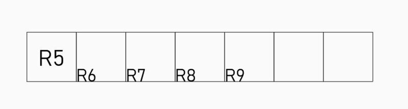

10 minutes ago, Leika said:
And you underestimate your skills because with your code I can keep my formatted Mtext.
I did not like your expression here at all and apparently you don't understand what's the meaning of formatted Mtext.
@Tharwat
English is not my native language, go to school as a nurse, indeed know little about AutoCad and Lisp but am possessed by AutoCad and Lisp. Can you forgive me because I took it as a compliment to you?
But what's the meaning of understand  for you?
I give example what I need but you give me very beautiful code that does the same as the code of expert Mac Lee... Those codes are sophisticated but I'm not one step further because that was not what I asked.
Of course I'm grateful for your time/code and can certainly learn a lot from it.
I'm here to learn from you, not to be told I don't understand something.
Just explain what people don't understand.EXCAMPLE.thumb.jpg.945dc77926820d306ec21f8e100a0d9b.jpg
Edited by Leika

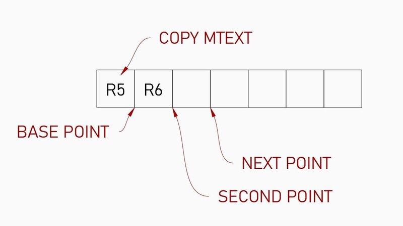

I thought I had it there for a moment, but not quite....
See below, and perhaps someone can point me in the right direction later. This isn't finished yet, it will need things like the cmdecho turning off temporarily and the error stopping, little tidying up.
This will work, copy mtext and text as required. The base point will move with the text which I thought was useful. I have used a few of the parts from your example and of course refer to that.
My problem is the copy loop and how to exit it, at the moment the copy loop will end on escape or with a right mouse click (as requested), problem is that it won't now exit with a space bar or an enter... does anyone know how to force a loop to finish if an enter or space is pressed within it? Or to detect if a space or enter was pressed during the last command (Looked briefly at grread, that might work), thanks
See the code below, highlighted  in ';;;;;;;;;;;;' what I a meaning

16 minutes ago, Tharwat said:
@Steven P Have you seen my post HERE it should answer your question in regard to exit quietly and safely.
Yes, though we are dong this in 2 different ways, mine works using (Command "copy"...... ) which allows the OP visual representation of the copied text as it is being copied, selecting the points is done within the command, your points are selected outside of the copy command and then copies the text (which is a lot easier to include some code to end the loop)? I can ask the user to select points before the copy line but then you loose the visual of the text moving,
So to escape my loop ideally I am looking for a way to detect whether a space or enter is pressed during the (Command "copy".... ), once I know how to do that I can put in an end to the loop
Probably use the grread function between picking the two points to allow visual rep. like the way lee mac uses it here.
but I have no idea how to use it.
-edit but a simpler coding solution maybe?

As far as I know I got out, definitely not perfect but got the base I wanted.
With the code you all show here I can build in and embellish many options with OpenDCL.
Thank you very much !
