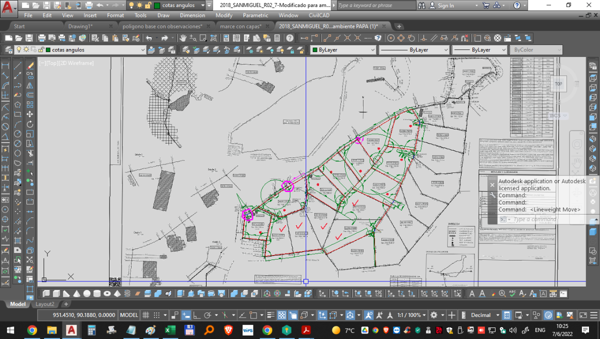

Since 2 days I searched for Bearing and distance to draw , I only found , from Drawn , get bearing and distance .
Mine  question is like a kinder garden pupil   at ACAD school.
There is a LSP to draw polylines, or consecutives lines give this data
Origin could be 0,0,0
end at vertex 9 .
My source is :  para lisp.png
Thanks in advance

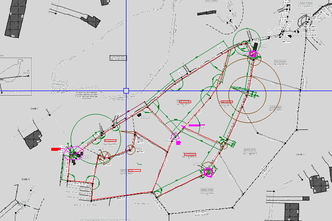

9 minutes ago, Isaac26a said:
I don't know if this can help you with what you're trying to do but, you can do this:
(command "pline" "0,0" "@181.91<0" "@230.26<81.36" "@79.44<172.0113" "@147.86<161.0922222" "@278.74<43.53611109")
But the angle should be in degrees, and it's measured from the X axis to the line, I don't know how to do that with entmake, just with the points or coordinates
Sad to say it do not work , as I said it are INTERNAL angles from each to each side
The blue lines is as it is , the brown is as your tip.
Edited by devitg
correct spelling

Hi @ all you , the fact is that I have to pass from PDF or  jpg or whatever to DWG old surveyor planes , i my region , small mountains.
like it
as suggested  @eldon
It is easiest to draw internal angles by drawing two lines on top of each other and then rotating one by the internal angle. The angle system does not have to be changed, just put "r" at the end of the numbers, and AutoCad knows it is a radian angle.
I did it so
and after it I had to draw the subdivision and join
as red point are divisions , tilde union or join
Thanks all for your help
Hi devitg, can not see in image does the lines have a BRG & Dist label ? Here in AUS the angle is not shown. Can see something next to lines.
@BIGAL
What you see , is what I did  taking from a ACAD.dwg printed as PDF , It is the way our CADASTRAL system work , all online , there is no more paper .

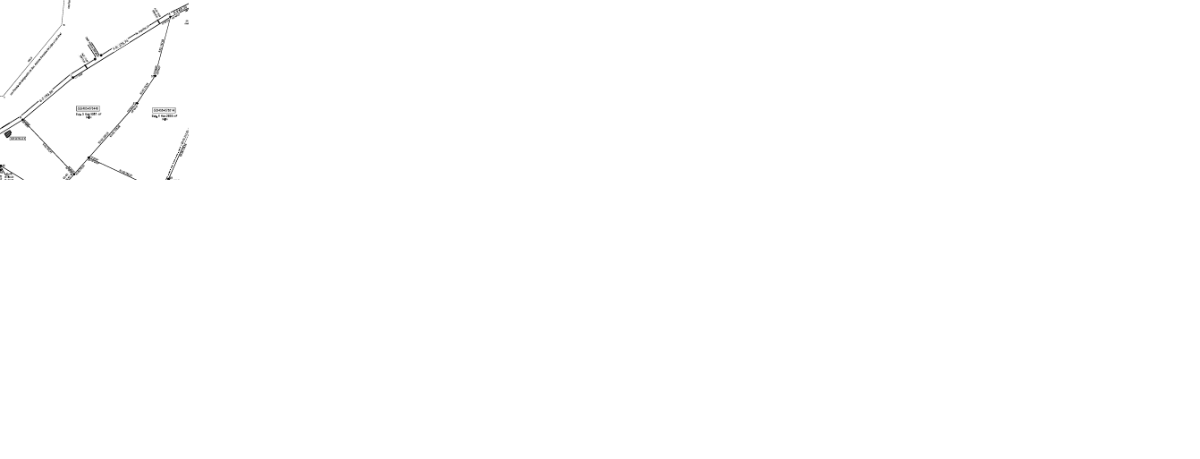

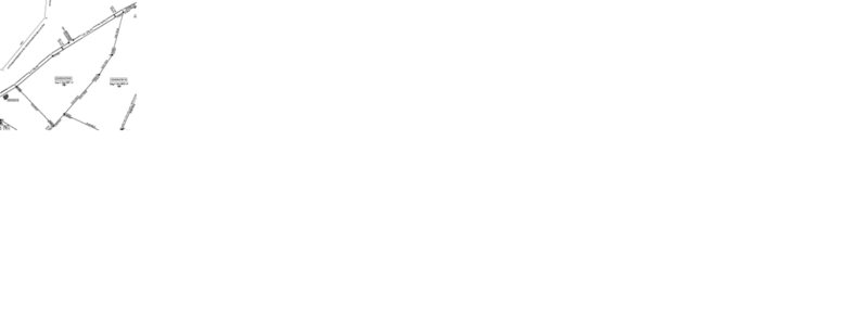

I don't know your works well, so I don't know how much accuracy you need
so, this is just my funny thinking
how about to use bmp lisp in this link https://www.cadtutor.net/forum/topic/75162-bmp-file-to-polyline-mosaic/
this screenshot is result of bmp, with removing background color (255 255 255) with 20% range
It only prints horizontal lines or dots, so it can't be used right away, but it's convenient to grab a snap. correct ratio
Larger screenshots and higher removal rates will give you better contrast and better results.

Hi devitg can you zoom in on a line there is something there but image is hard to see. Is it BRG & Dist ? That is the way my code is written enter values from plan.
