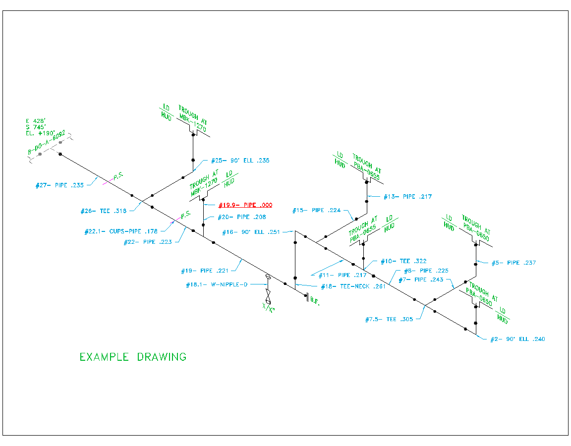

I am in need of a LISP that will be used in a batch I will be running for a client on thousands of drawings before turning them over.
Essentially I am trying to develop a LISP that would search all TEXT/MTEXT entities in a drawing and if it includes what we call "data readings" on the end (e.g., .128, .220, .000) then they need to be removed, else do nothing. Some very old drawings may not have the thousandths, only tenths and hundredths (e.g. .12, .07, 34...) but I need the LISP to ultimately remove the decimal and anything after it if it exist in the drawing.
There are multiple instances of these within each drawings so they will all have different location names to which they are referring to on the pipe (e.g., PIPE, TEE, ELBOW, etc....), and also some may or may not have readings. The LISP would just skip those that do not have these readings.
EXAMPLE (Datapoint Locations with data readings):
#18.1- W-NIPPLE-D
#19.9- PIPE .000
#26- TEE .318
#22.1- CUPS-PIPE .178

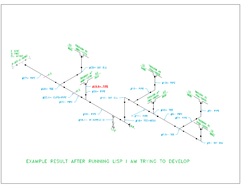

EXAMPLE RESULT AFTER SAID LISP RUNS (Datapoint Locations WITHOUT data readings):
#18.1- W-NIPPLE-D            [IGNORED BY LISP BECAUSE NO DATA READING WAS DETECTED]
#19.9- PIPE                          [PROCESSED BY LISP AND .000 WAS REMOVED]
#26- TEE                               [PROCESSED BY LISP AND .318 WAS REMOVED]
#22.1- CUPS-PIPE              [PROCESSED BY LISP AND .178 WAS REMOVED]
....continue for remaining
Please see the sample images I have provided of a drawing before and after the LISP I am trying to develop. I thank you in advance for even giving my post the time of day and as always you guys rock and I appreciate you.

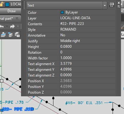

Would all text be at this layer only ?
The sample text is at other layer
@devitg our normal standard is text that contains a normal reading falls under the LOCAL-LINE-DATA blue layer. However, if we have a failing reading it defaults to LOCAL-LINE-HIGH red layer to stand out more. I am not totally concerned about specifying exact layers to look at which is simply why I want to look at all text and mtext entities but I guess we could add something like this to account for MTEXT and TEXT on layers ending in DATA and HIGH:
    (if (setq s (ssget "X" '((0 . "TEXT,MTEXT")(8 . "*DATA,*HIGH"))))
I really appreciate you responding and helping me. I hope this answered your question.

Try this ... does not check for locked layers.
(defun c:foo (/ a i o s)
  (if (setq s (ssget "_X" '((0 . "TEXT") (1 . "* .#,* .##,* .###"))))
    (foreach e (mapcar 'cadr (ssnamex s))
      (setq a (vla-get-textstring (setq o (vlax-ename->vla-object e))))
      (setq i (vl-string-position 32 a 0 t))
      (vla-put-textstring o (substr a 1 i))

Definitely test it out before shredding a directory of drawings.
The filter will only grab end numbers up to 3 digits long so if there are any longer than that just keep adding # like so separated by commas:
(1 . "* .#,* .##,* .###,* .####,* .#####")
