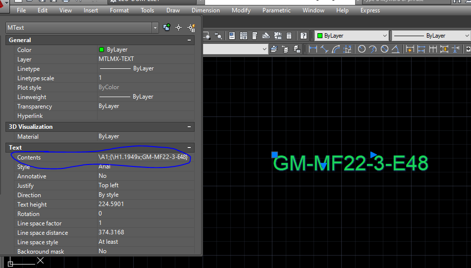

Maybe it's because of the attribute character that exists only in mtext. This can be solved by LM:Unformat.
or mtext inside a block
Edited by exceed
Use THIS to get a 'clean' string.
Or if these are one line mtext, exploding them will work too.
Edited by ronjonp
Adding to Ronjonp, the mtext displayed on the screen has invisible formatting data embedded in it, the \A1;{H1..... and so on to say how to display the text, and that is what is shown in the properties. To make useable text you have to remove these formatting codes, which Lee Mac des in the Unformat Lisp above

  On 5/31/2022 at 10:05 PM, leonucadomi said:
I tried to extract the content of this text but I don't know why it has other content internally
image.thumb.png.a33b79edb537f510000a4fc87509951c.pngimage.thumb.png.1f971deec67901be7f15d8ef57a24a1b.png

Like this,
MTEXT can specify more details than specifying font, width, and width in dtext.
These are stored in text content, not in Properties.
Therefore, if you want to use the contents of MTEXT in other places,
you need a format remover such as LM:Unformat.
