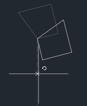

To rotate a view, all you need to do is run the macro and then enter the angle.
^C^C_dview;all;;tw;\;^P(progn(setvar "snapang" (- (getvar "viewtwist")))(princ))
Is there a way to make it snap using the mouse snaps.
For example, if I rotate a shape I can snap the rotation angle using the mouse. See below.

Have you looked at UCS OB plan, this will set a UCS to the direction of a selected object.
How would you incorporate into the code?
Draw a line on a angle UCS OB pick line then type PLAN.
I don't really understand.
This is a for a viewport as well.
We only used viewports in layouts not model. So we would do UCS OB S giveitaname. Then go to layout viewport and UCS R giveitaname plan.
Sorry it's not working as expected.
It sounds like you want something different to what I am suggesting, post some images.

Modifying the one you have to allow either entering an angle or using snaps to set snapang then using that value for dview twist:
^C^C^P(setvar 'angdir 1)(setvar 'snapang (getangle "Pick or enter TWist angle : "))(setvar 'angdir 0)(command "_.dview" "l" "" "_tw" (/(*(-(getvar 'snapang))180)pi) "")
To make sure angdir is reset and to unlock then relock a viewport you want to twist this slight modification of BlackBox's lisp is what I'm using:

Hi, thanks, I've tested initially and this works really well so far.
Cheers.
