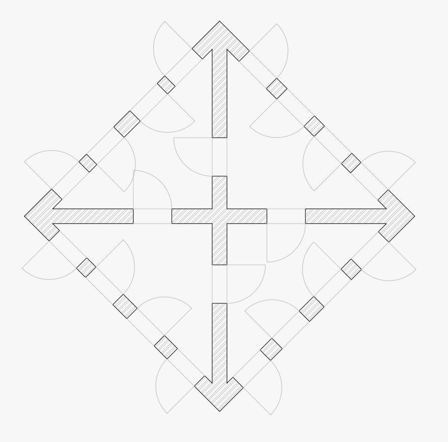

Hello all,
I found this code from alanjt.
It draw an arc that i want to use for my doors.
Works fine for me and happy, but how can i change the color when draw the arc?
Does anyone have an example of how to do it with entmake?
(if (and (setq p1 (getpoint "\nSpecify first point: "))
        (setq p2 (getpoint "\nSpecify end point: "))
        (setq rad (getreal "\nSpecify radius: "))
        (command "_.arc" "_non" p1 "_e" "_non" p2 "_radius" rad)
Thank you very much to read my problem!

So in your code the line (arc_ p1 p2 rad) should be (arc_ rad p1 p2), however I think cons 50 and 51 should be angles? See this from Lee Mac, ' http://lee-mac.com/3pointarccircle.html#3parc ' to create a 3 point arc, you will need to use the 3 point circle LISP and 3 point arc LISP to make it work. I would be tempted to use this routine and change your method to selecting the 3 points rather than selecting 2 points with the mouse and then entering a number with the keyboard if that works for you?
A door between 2 points can have 4 answers as you have left right and top bottom. Adding say a rad that is -ve is not a bad idea so will add arc n other side.
There is a dynamic door block with all 4 answers built in will see if can find. Some one else may post before me.
I initially used different door blocks.
What later switched to an arc is entered with point1 point2 and radius.
A little later I wanted to be able to color the arc and I have now succeeded with that code from expert Lee Mac.
The code here is just an example of what I wanted to achieve because I break the walls to put the doors in there and everything goes as planned! (Photo attachment)
It remains for me to thank you both! 🥰
This was also an opportunity to keep the code simple.
(command "_.chprop" "_last" "" "_color" 9 "")
