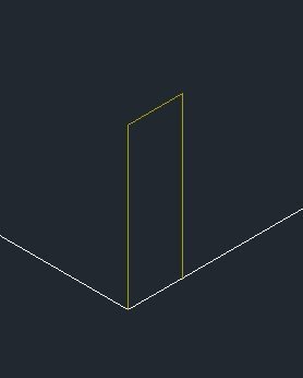

I'm trying to join 4 lines together into a rectangle and no joy.
command line - select lines, arcs and polylines
appears, i select the lines and nothing happens.
I tried drawing just 3 sides of the rectangle and then used the PC command to 'close' them and this didn't work either.
I must be doing something stupid. If you could correct the error of my ways i'd be most grateful
So what does AutoCAD say in the command line when you try PC ? that might give an idea of what is happening. I am guessing that your 3 lines are drawn as 'lines' and not 'polylines'? If so you'd either need to draw them again as polylines, use the pedit command, selecting them to convert to plines of Lee Macs PJ command (should be in the same place as PC)
Another method you could try are the fillet or chamfer commands setting the radius or D1, D2 distances to 0. Draw the 4th line and then connect the ends like that, as above though if these are drawn as lines then they will stay as lines rather than polylines.

Is  this pline standing vertical if ? If  so use thickness it will draw what you want.
Mr Steven P,
Exactly my problem, thank you, consider solved and me stupid
