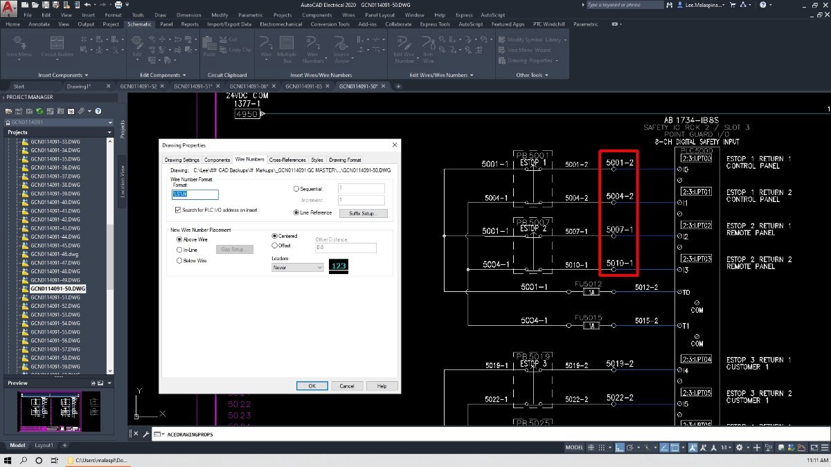

When I generate automatic wire numbers AND have the correct settings to search for the PLC address, I still get liine numbers. I believe the blocks are not functioning properly. I have put known good blocks into the drawing and they fnction as intended. IUs there a quick and easy way to "fix" blocks like these?

I had corrupted drawings, messed up blocks and other issues were in this print set, if anyone cares.
That's useful, thanks for getting back with the solution!
My answer was worded poorly but it is correct. I found several PLC card blocks that just plain did not work, I replaced them and the problem disappeared. Other drawings would not behave properly no matter what so I rebuilt those using another drawing, renaming it and setting it up in the project manager. Later, in some drawings, I zoomed in and found that the wires were not actually touching the point on the attributes of the block. So much for turning on SNAP and making sure things actually snap to the desired point!
Line numbers that were wrong come down to line number blocks with incorrect information entered for ladder number distance. These drawings have a lot of garbage from the past in them. Nobody seems to care about these things but me. When I drop a relay coil in at line 1020 and AutoCAD names it CR1026, duuuuh, something isn't right! I suppose I will just have to get used to other people's sloppy, stupid habits.
