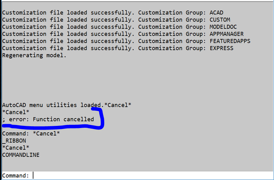

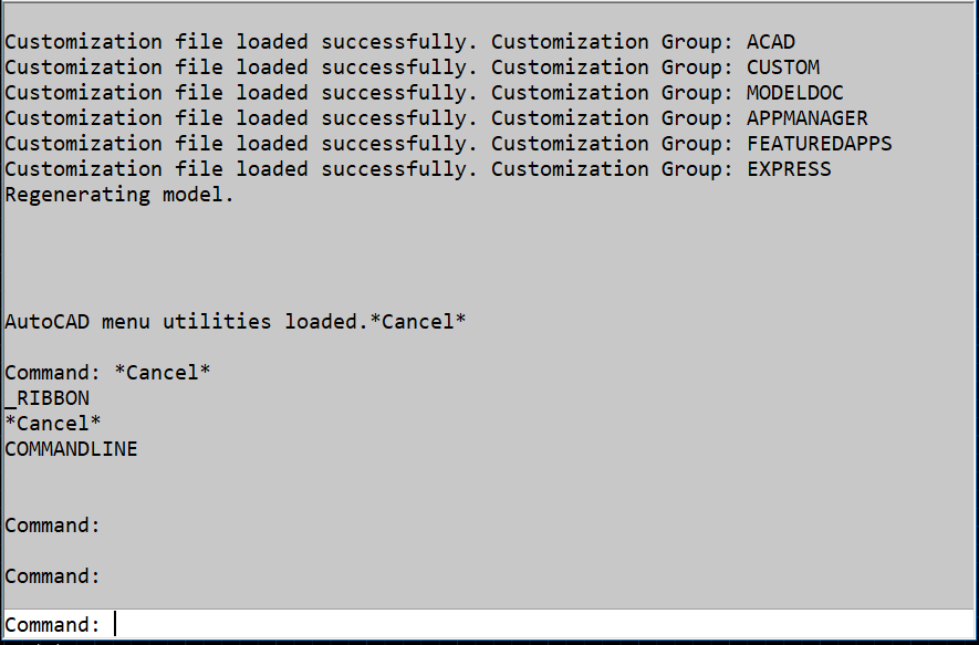

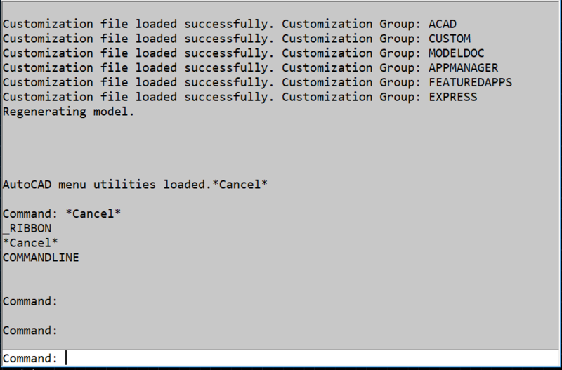

Thank you so much but i found a problem. This autocad's normal starting.(1st photo)
After clicking on the option to load the lisp file continuously from the Appload menu, I closed the Autocad program and reopened it. It is waiting in the "startup-load" menu when opening Autocad. When I press ESC, autocad completes the opening process. (2nd and 3rd photos)
Edited by Scoutr4
Why repeat load just appload once, to do again type 2fil. Thats what the C:2fil means its a command now just run on 1st load.
  • Agree 1
Okay. I draw electrical installation projects. I'm currently using over 15 lisp files. I open at least 30 or 40 dwg files every day. If I upload all the files once, I always have to do this again when I open the dwg.
As soon as it was installed from the Appload menu, the command was working and was asking for the radius even though I didn't enter the command.
so it probably loads the command when autocad starts and asks me to enter the radius during "startup load" and autocad program fails to start. I deleted the last row and this problem solved. Thank you again.🙂
