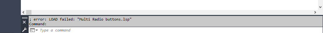

pmadhwal7 Posted May 8, 2022 Author Posted May 8, 2022 On 5/7/2022 at 4:13 AM, BIGAL said: Multi getvals and multi radio buttons.lsp are here in Cadtutor download. Quote
BIGAL Posted May 9, 2022 Posted May 9, 2022 Multi getvals and multi radio butons.lsp are here in Cadtutor download. Quote
