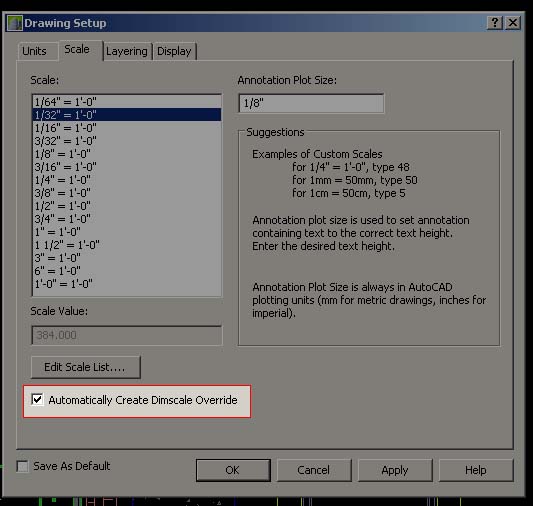

i've run into this quite a few times where i would open a drawing and there would be an override on the current dimstyle...i would clear the override and save the drawing...another day i would open the file and the override is created again...
i greatly suspect that the annotation scale is the culprit...when i check the dimstyle override the scale for dimension under the fittab is set to a number reflecting the scale...ie if the annotation is 1"=1'-0" it will be 12...if it's 1/4"=1'-0" it will be 48 etc...
i also noticed that an override is created after editing a dynamic block...
in addition to the above, the override is not created if the anotative scale is the same as the "fit" number...humm...
anyway, long story above, is there a variable i can set to prevent this?..

i found it!!!!
must be ticked off (unlike in the attached image)....i knew it was somewhere...

So I guess your problem was specific to ADT. :thumbsup:
why, is that option not available in vanilla?..
It is not on mine that I could find.
humm, i just type in units and go to the scale tab...strange that this is not available as both version use annotation scales...oh, well...
Here is what I get when I type in UNITS....
ok...so how do you go about creating/editing annotation scales?..
We have a little button to push in the lower right corner
[ATTACH]2246[/ATTACH]
and hit custom, or type in _scalelist edit for this box.
[ATTACH]2247[/ATTACH]
humm...well waddayaknow...ok, then...autocad architecture only quirk...i wonder about the other verticals...

Hi Guys-- I'm Back! Hope you Cadsters are doing well, enjoying the autumn in the Northern Hemisphere, etc.
So I'm in Arch 2009 and my CANNOSCALE is set to 1/8"=1'-0" and previously my scale units were visible in my drawing. Now suddenly they're so tiny, they've disappeared (1"=1'). This keeps happening! I can force a change back to 1/8"=1'-0" each time by going into Anno Object Scale (through Properties). However, I cannot for the life of me find the Drawing Setup box that Hazardman shows above--I think the DimScale Override is killing me! I keep looking through my Dim Style Mgr. and CANNOSCALE gets me no GUI at all. Aauurrggh! Thanks in advance.
