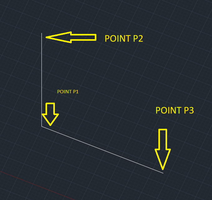

i have to find the angle between two 3d point
HERE IS MY CODE
(defun c:foo ()
  (setq p1 (getpoint "\n1st:")
    p2 (getpoint "\n2nd:")
(setq ang (angle (trans P1 1 2)(trans P2 0 2))
but this code does not give the correct angle between point
Actually I need to calculate angle between only 2 point
If user select 2 point (i.e point1 and point2) then angle has to come 90 degree
And angle between point p2 and point 3 has to come 0 degree
And angle between point p3 and point p2 180 degree
2 points define a line and only one.
In 2d, an angle is defined by 2 lines in the same plane.
angle function always project the 2 points in the xOy plan.
angle function assumes the first line as Ox and second as the line defined by the 2 given points.
So, "Angle between two 3D points" has no meaning at all. You have to define the projection plan.

The ANGLE function determines the angle formed by a line passing through two points and the X WCS axis.  To find the angle between two lines that may be at any orientation in 3D space define two unit vectors, v1 from from point 1 to point 2, and v2, from point 1 to point 3.  Then take the arc-cosine of the dot product of the two vectors for the true angle.

Two points define one line.  To find an angle between two lines you need another line stated either explicitly  or implicitly.  The lisp function angle assume implicitly that the "other" line is the x axis. What assumption would you like to make about the other line if only given two points?
A program could output, for example, the angles between the line defined by two points with the world X axis, Y axis and Z axis.  It could also output the angle with it projection onto one of the principal planes (e.g., the XY plane) or...  What do you need?  Be as detailed as possible.

There is p3 in the picture saying you only need 2 points. this confused me. haha
"If user select 2 point (i.e point1 and point2) then angle has to come 90 degree  = this is xz plane
And angle between point p2 and point 3 has to come 0 degree = this is rotated xz plane.
And angle between point p3 and point p2 180 degree"  = this is rotated xz plane.
> this is second confused point. if p2 -> p1 in 2nd and 3rd line. there 3 lines explain just 1 xz plane.
