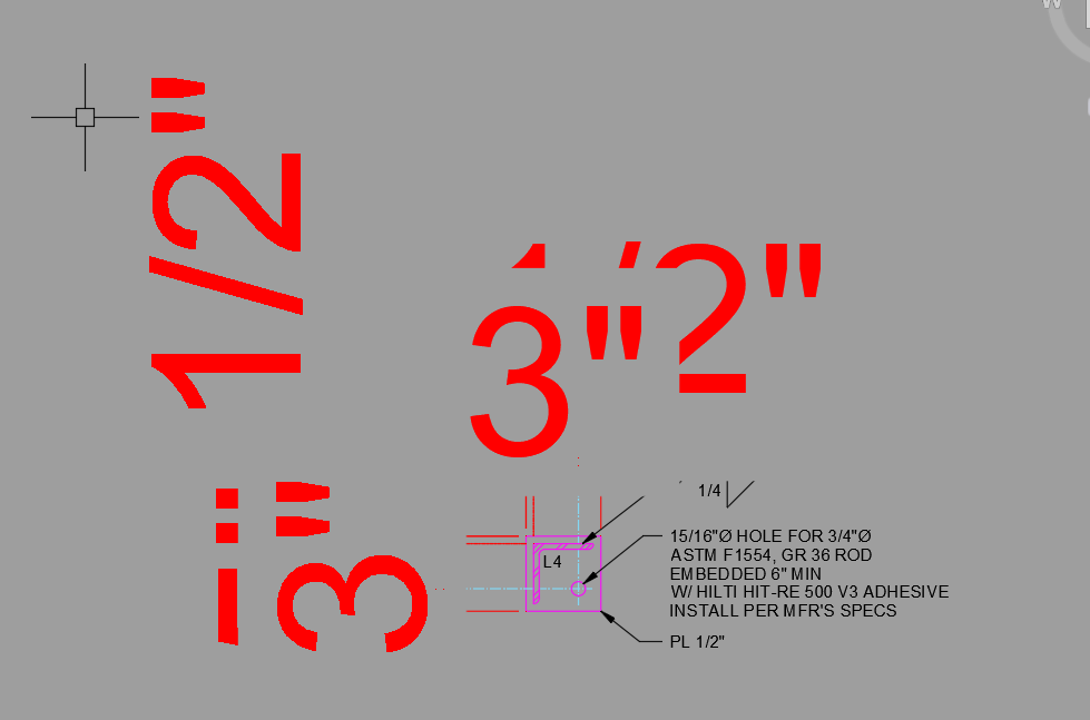

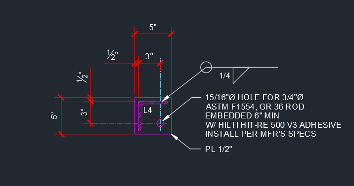

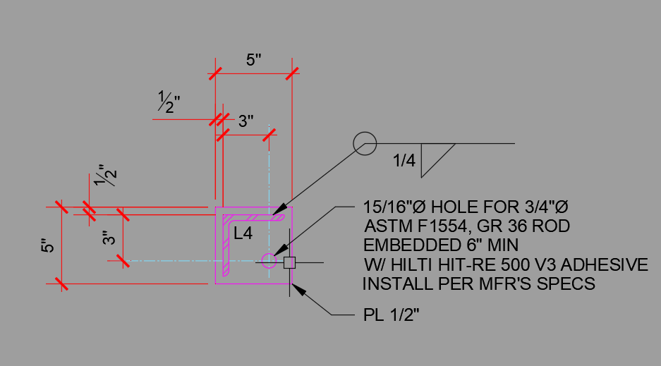

I am using AutoCAD at new new job and finding out there structural Steel details where explored from Revit!
Insert detail block into a drawing at 1/8”=1’0” and try modifying the detail the dimension change. The dimstyles, Textstyle and layers in the details are wrong.
After realizing every detail in our library was explored from Revit and never cleaned up.
So now I opened can of worms and it up to me to clean up all 300 details.
What I had to do to clean up details. Details are 1 -1/2” scale
1.         setcurrent dimstyle to Annotative before deleting all others, but EE-STD_DIM_STYLE dimstyle
2.        Purge all layers, dimstyles and textstyles
3.        Select all dimension and set to Dimstyle cloes to the one I need to change to. Sample EE-STD_DIM_STYLE
4.       Inserted block with all layers, dimstyle and textstyle.
5.       Re-select all dimension again, change Dimstyle to correct one from the drawing inserted.
6.       Purge the EE-STD_DIM_STYLE Dimstyle and save
7.       Purge base drawing of that detail, re-insert and it is fine.
I am look for lisp or script file to help with cleanup.
I know just little bit of lisp, know how to create script file!
Can any one help?

Thanks, but it really didn't help much.
layers worked in the lisp routine,
dimstyle only removed the Annnotative from the list
textstyle did nothing.
Thanks for trying.
what I am thinking is set the "Dimstyle "SET Current" to EE_STD_DIM_STYLE, delete all others, but all dimensions have to be change to "EE_STD_DIM_STYLE" before this cleanup.
insert DETAIL SHEET.dwg with layers, styles and dimstyle.
Detail.dwg
added few details with wrong dimstyles that Revit created.
DETAIL SHEET.dwg BPL5-E-1B.dwg BPL6-CIP-1B.dwg
