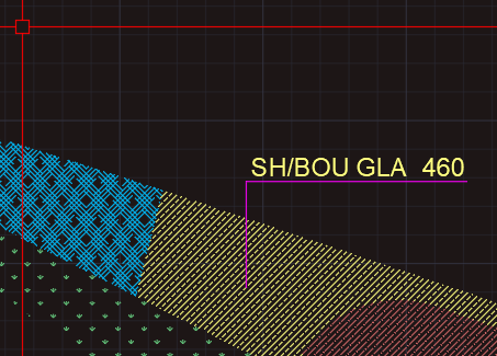

Hello,
Just would like to ask what's the best way to do such thing as mention on the title
to explain further, I want to, for example, select a Hatch and detect its layer (ex. BouGla, AtrPlx, PhiSel) and get the total planting Value of said Hatch, but each have separate nos per sqm (ex. BouGla, 3nos per sqm)
In short, how can I bind the nos per sqm in a layer.

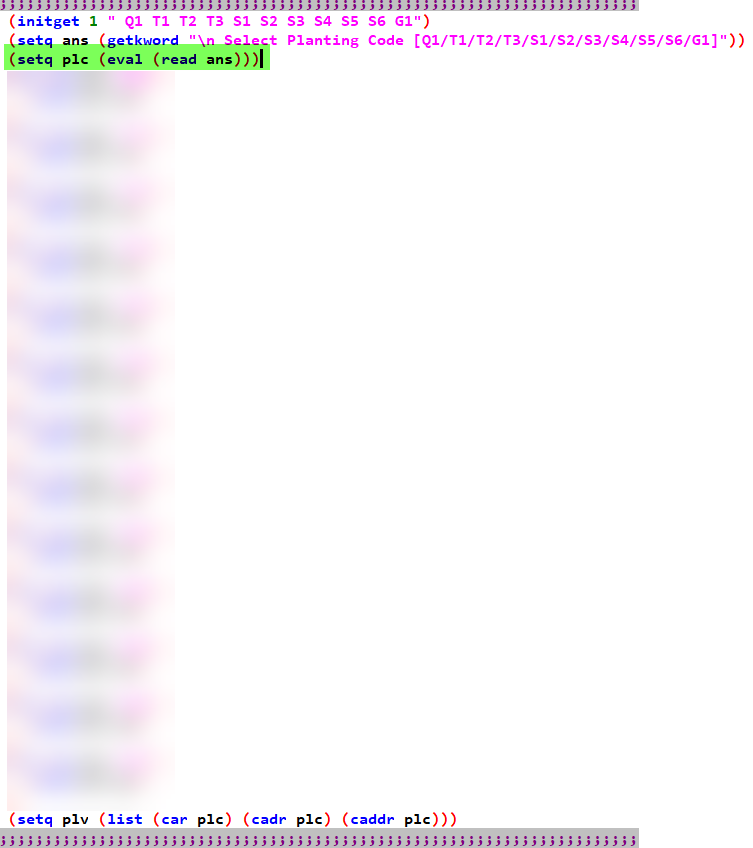

One quick simplification:

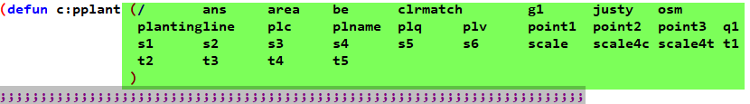

And make sure to localize all those variables:
I'd use an association list like so to get your input:
(defun c:pplant	(/	  ans	   area	    be	     clrmatch justy    osm	plantingline
		 plc	  plname   plq	    plv	     point1   point2   point3	scale	 scale4c
		 scale4t  values

  (setq	values '(("Q1" "P/PHOE.DA" 10000 "N")
		 ("T1" "T/CONO.ER" 10000 "N")
		 ("T2" "T/CONO.SI" 10000 "N")
		 ("T3" "T/EUCA.OB" 10000 "N")
		 ("S1" "SH/CALL.CA" 0.57735 "Y")
		 ("S2" "SH/CLER.IN" 0.70711 "Y")
		 ("S3" "SH/DODO.VI" 0.57735 "Y")
		 ("S4" "SH/LEUC.FR" 0.57735 "Y")
		 ("S5" "SH/NERI.OL" 0.70711 "Y")
		 ("S6" "SH/THEV.PE" 0.70711 "Y")
		 ("G1" "GC/RUEL.BR" 0.40825 "Y")

  (initget 1 "Q1 T1 T2 T3 S1 S2 S3 S4 S5 S6 G1")
  (setq ans (getkword "\n Select Planting Code [Q1/T1/T2/T3/S1/S2/S3/S4/S5/S6/G1]"))
  (setq plc (cdr (assoc ans values)))
  (setq plv plc)

Thank you for the reply, I will sure look into association list, Just want to ask why do i have to localize all those variables? also I've read about substr and came up with this;
(if (eq UNIV-SCALE nil) (Alert "PLEASE SET UP SCALE FIRST") (progn  	 	;checking if scale is set
  	(setq 	eL	(vlax-ename->vla-object (car (entsel "alin ba"))) 	;getting layer
		cL	(vlax-get-property eL 'Layer))				;convert layer to string
	(if (eq (strlen cl) 22) (progn						;checking if layer is correct
	(setq 	PL-C		(substr cL  1 (- (strlen cL) 15)) 		;Yield Planting Code
		PL-T		(substr cL  9 (- (strlen cL) 20)) 		;Yield Planting Type
		PL-S	(read 	(substr cL 12 (- (strlen cL) 18)))		;Yield Planting Spacing or nos per SQM
		PL-UN		(substr cL 17 (- (strlen cL) 19)) 		;identifies if computation is by spacing or nos per sqm
		UN		(substr cL 21 (- (strlen cL) 0)) 		;unit of said drawing
		AREA 	(vla-get-Area eL)					;getting area of selected hatch
		asd-p1	(getpoint 	 "\n 1st point")			;first point for leader
		asd-p2	(getpoint asd-p1 "\n 2nd point")			;second point for leader
		asd-p3	(getpoint asd-p2 "\n 3rd point")			;third point for leader
		asd-p3m (list (car asd-p3)(+ (cadr asd-p3) 12) (caddr asd-p3))	;for mirror block
		PL-C-F	(strcase (strcat "" PL-T"/"PL-C))			;combinding code and pl type
with a layer "BOU GLA SH 0006 NPS MM", I extract the needed information by dissecting the layer, so needless to say I resolve it but still thankyou for the reply kind sirs.
about variable localization, see this link.
http://www.lee-mac.com/localising.html
It may work normally on the first run, but after the second run, the old value may remain and an error may occur.
Setting the initial value at the beginning of every defun doesn't cause a big problem, but there is the following problem.
If other Lisp is loaded and used, unexpected results may occur if the Lisp and variable names overlap.
These problems can be solved by simply writing (defun c:test ( / variablea variableb variablec )~~
