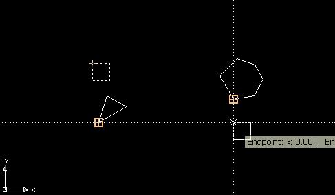

MaxwellEdison Posted February 13, 2009 Posted February 13, 2009 I typically use OTRACK,first I hover over the osnap, move my cursor along the proper polar direction and then enter my distance. Or if I don't know the distance, I hover over the osnap point, move an arbitrary distance perpendicular to the direction I want to move, then hover over the osnap for the destination point and move my cursor to where the objects share a perpendicular intersection. See my example below since its kind of a hard concept to explain in words. To do this you must have POLAR angles, OSNAPs, and OTRACK enabled ([F10], [F3], and [F11] repectively by default). ***Edit*** I reread your reply to Dave and I think you'll be able to do what you want by using MOVE->FROM->(base point on object)->(base point on 1st reference object)->(OTRACK for point horizontally alligned to 1st reference object and alligned to second reference object) I promise this is not as difficult as it sounds, just hard for me to explain simply. Quote

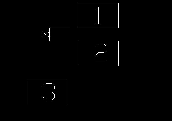

wannabe Posted February 13, 2009 Author Posted February 13, 2009 Imagine I wanted to move box 3 from its mid-point on the top horizontal line, from the mid-point of bottom horizontal line of box 2. I would use the from function. But then say I wanted to move it by distance X immediately after choosing my FROM point(bottom of box 2). I would have to know the distance of X and type it in. I couldn't use a point on box 1 and then and then the corresponding point on box 2. Quote

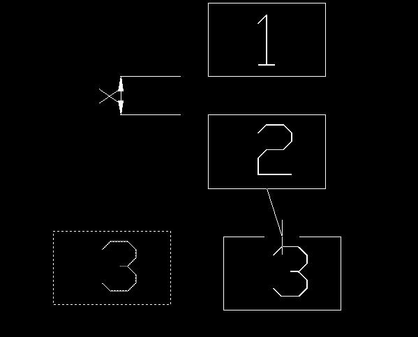

wannabe Posted February 13, 2009 Author Posted February 13, 2009 See here. Box 3 has been moved, and the point on box 2 has been selected as the point to move FROM. All I can do is type a distance or click a location. I cant pick the top left of box 1 and the top left of box 2 as the direction and distance to move box 3 whilst this operation is still active. I need to move box 3 to box 2. Then move box 3 using a point on box1 and a point on box 2. This would be good when I'm manually creating a key, as one example. Quote
MaxwellEdison Posted February 13, 2009 Posted February 13, 2009 Okay, I see your dilemna now, otrack simply is not enough here. I've cobbled together a quick macro so you can create a custom command, I called mine "movefrom" ^c^c_move;\;\\_move;p;;from;0,0,0\\ Hope that works for ya Quote
