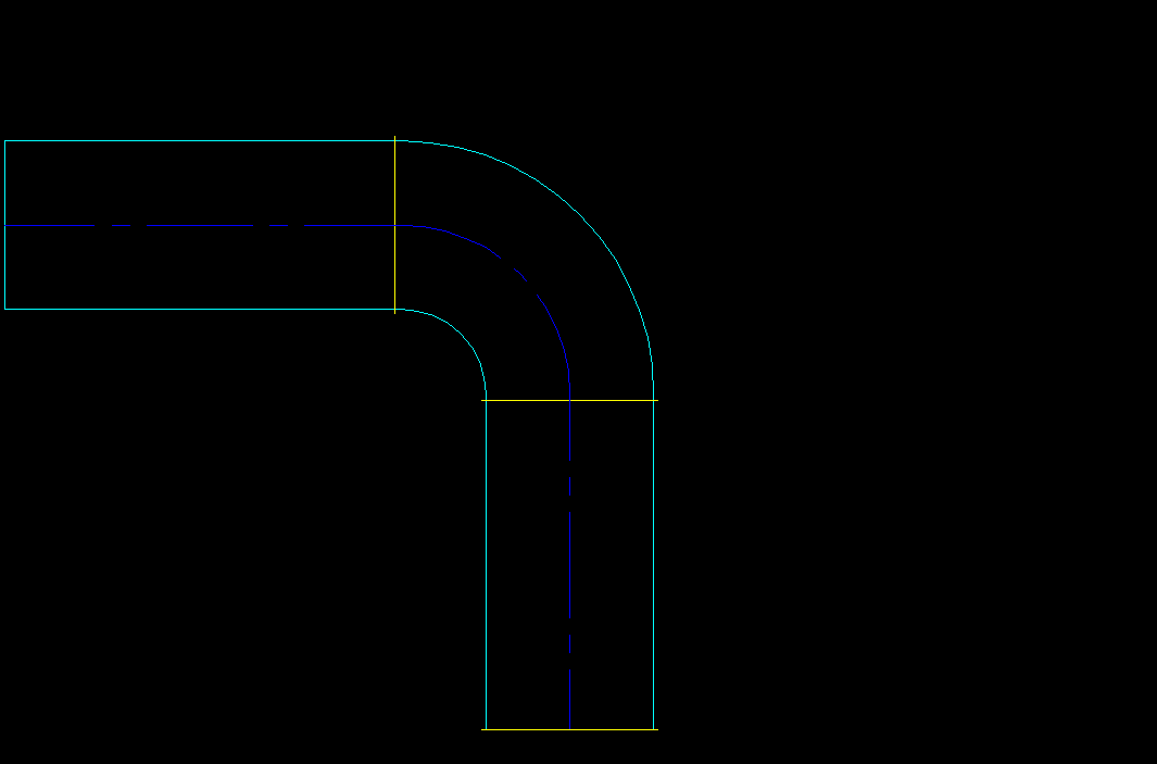

Hello everyone, when I choose to modify the radius of the bilateral arc to a fixed value of 200mm, I seem to have done it, but my requirement is that the yellow lines on both sides can also move to the starting point of the new arc, or delete the original yellow line , you can also create two new lines, (note that the color of the line here is not a fixed yellow) What should this be done? Or is there a cleaner way to achieve this than mine? Or is there a vulnerability in my code? Please advise

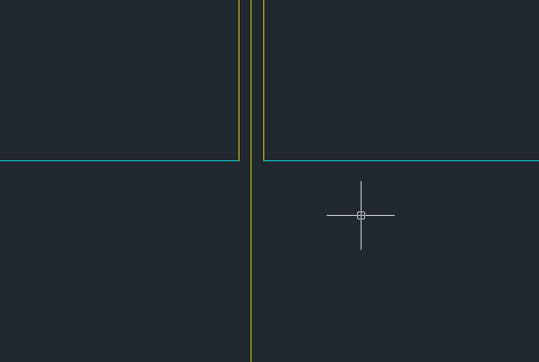

There are a little things to consider before moving on to the next step.
1. There are 3 yellow lines.
2. The middle yellow line is 60mm longer than the other two lines.
3. The spacing between fittings is 0.2mm.
4. The straight offset value of the elbow fitting is 50mm. = The arc starts 50mm behind.
Drawing the line at the arc's endpoints successful
but have to think about which direction to look for the 50mm offset line.
As a simple method, this Lisp uses the (ssget "w") option,
so it may be a way to delete the line in the area,
connect the broken light blue line, and then create 3 new yellow lines.

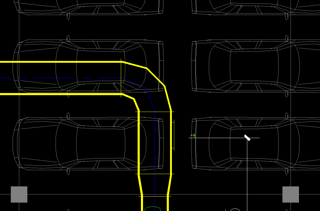

Thank you for your suggestion. I am amazed that your observation is very detailed. I didn't find it. Okay, let me rearrange the logic of thinking first.
ss
Edited by ekko
If your drawing the elbow from scratch, why can't you find the "Yellow" lines and delete them, when you drew new end lines you drew "White" lines why were they not "Yellow". So would work again. Color is valid as a line property same as if its on a different layer.
As described by @exceed, there is a 50mm straight line segment before the arc, and there is a gap between them, that is to say, the arc does not intersect the yellow line. It takes a lot of judgment to find the yellow line at a time. The problem is, this The color of the yellow line is not a fixed yellow, it may be red, green, blue... I think that the lisp made by distinguishing by color is only used for test drawings, and there may be bugs when using it on another drawing, it should be Seek some other way to make it generic

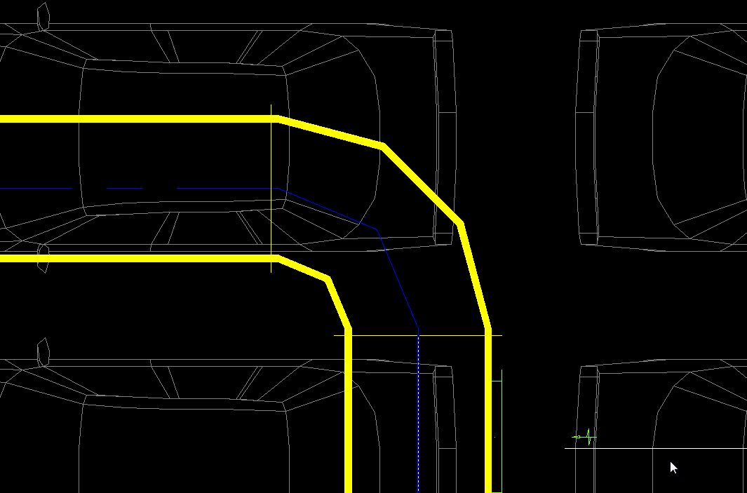

Hello everyone, according to the ideas and help you provided, it seems that it is about to succeed. Unfortunately, only when the object is line, when the object is Lwpolyline, it doesn't seem to work. I spent a lot of time to check the information, but never came up with a solution, The problem is that my graphic elements are stored in the list, and I don't need to select them at all. What should I do? How to do it?
