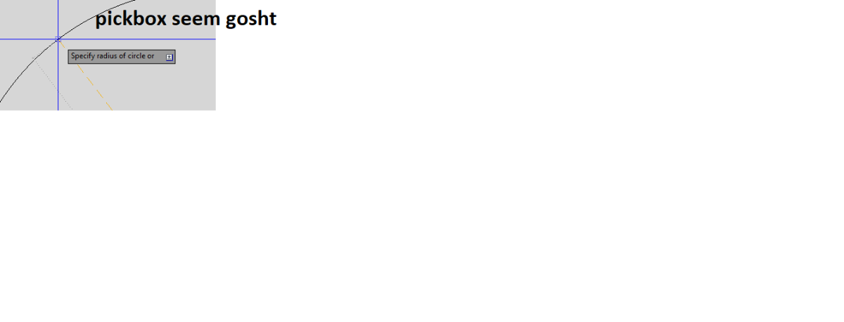

Hi , I do not know why or when but my pick box becomes as shown ,
Which system variable control it ?
Thanks in advance
I don't know if I understand the meaning well.
PICKBOX is activated only when PICK is performed.
It is not visible when making adjustments and window selections.
or There may be a syntax in your Lisp that sets the PICKBOX variable to 0.
The PICKBOX variable has a value between 0 and 50, and usually 5 is sufficient.

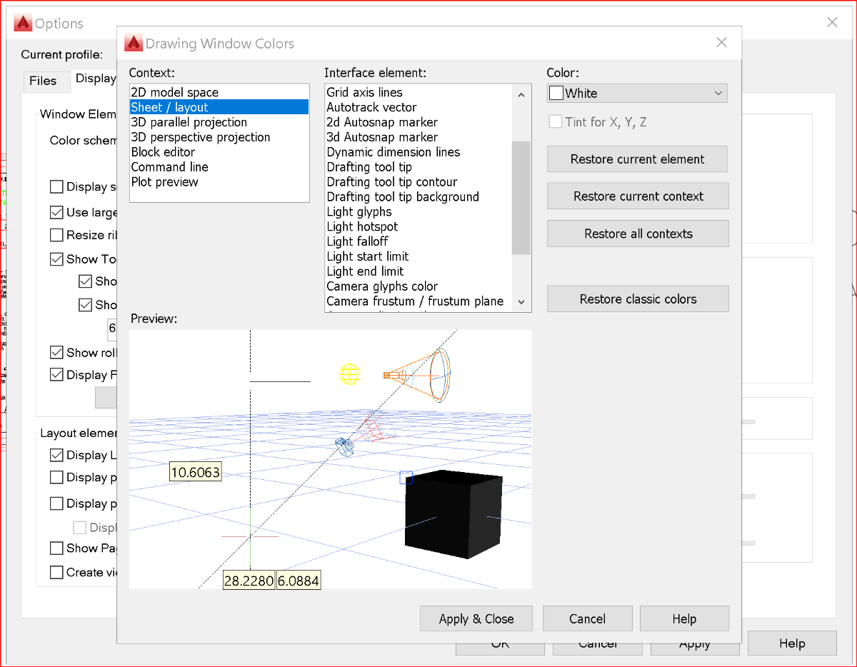

or The background color looks like a block editor.
In OPTIONS, you can specify the color of the crosshairs inside the block editor separately.
or if it is Unstable problem
by GRAPHICSCONFIG, and 3DCONFIG command
you can off HW accelerations. some cases it works

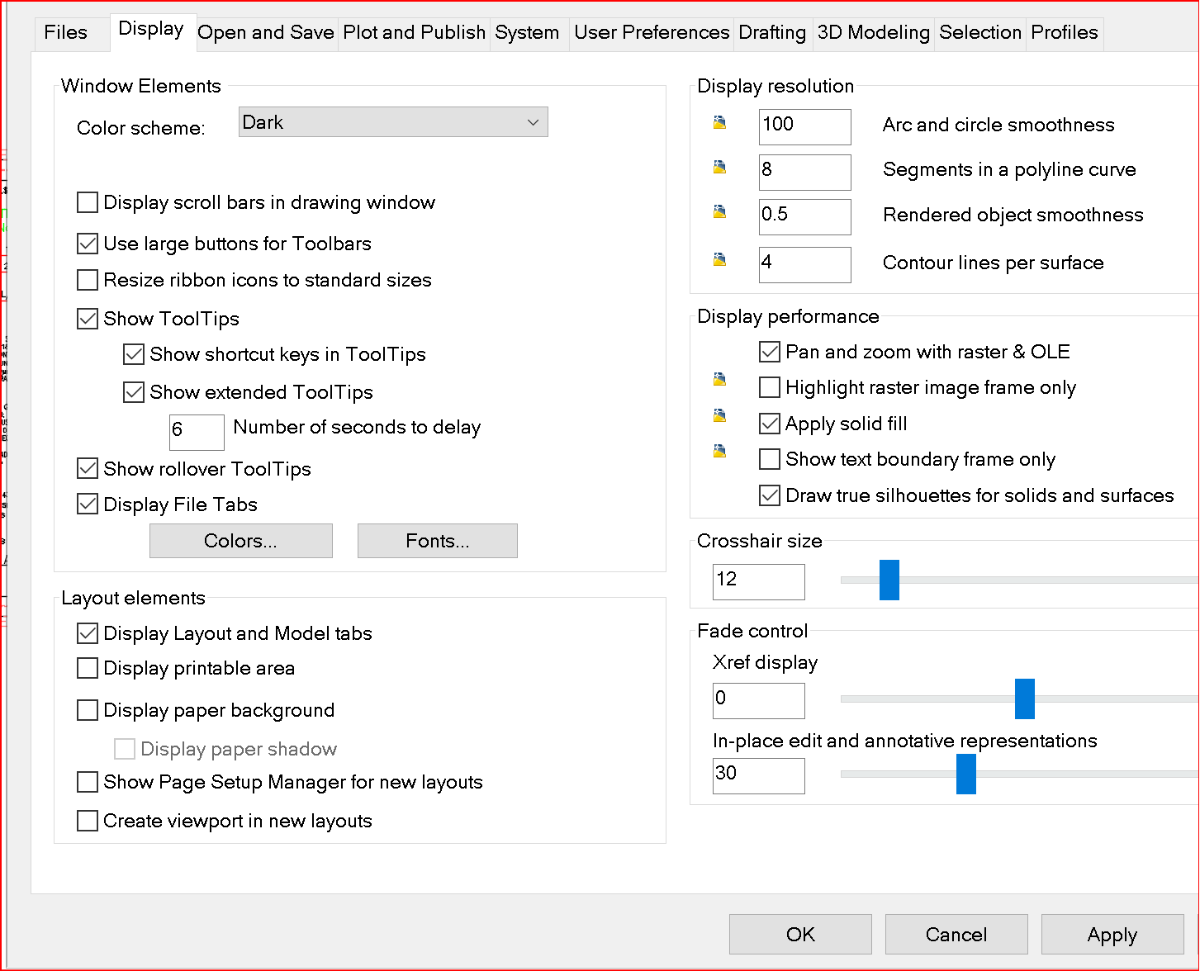

Possibly something has changed in your OPTIONS
on the DISPLAY tab
Click on COLORS

Hey, I had never noticed, bit you have the COLORS option right there too, very convenient!

And at the last right label  "PROFILES" you can save your setting , and as many setting as you want to . the file has ARG extension
so you can set as desired.

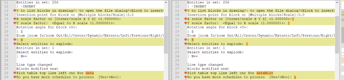

Did you try the logfile compare ? Handy when trying to find a variable name. Your other post at forums/autodesk.
HI@BIGAL , please clear me. How to do?
Hi devitg
Logfileon
setvar
may need press enter to get all pages of setvar
Logfileooff
You now have a logfile.log its saved here. I have mine set to a TEMP directory easier to get at.
Ok change 1 variable only.
Do all the steps above again, you now have 2 Log files and can compare.
In Notepad++ is a compare option makes it much easier. If you dont have Notepad++ open 2 Notepad files and scroll. I think I had to add it to Notepad++ it was in plugin options.
