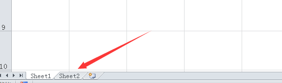

CAD output excel specified page
ekko
(setq xlApp    (vlax-get-or-create-object "Excel.Application")
      xlBooks  (vlax-get-property xlApp "Workbooks")
      ;xlBook   (vlax-invoke-method xlBooks "Add");Get the active excel that is currently open, instead of adding a new one
      xlSheets (vlax-get-property xlBook "Sheets")
      xlSheet  (vlax-get-property xlSheets "Item" 2)
      xlCells  (vlax-get-property xlSheet "Cells")
May I ask how to get the sheet2 page in the currently opened table, how to modify the above code, can it be achieved?
Something like this with your variable names
getexecel.lsp:        (vlax-put-property (vlax-invoke-method (vlax-get-property *ExcelApp% "Sheets") "Add") "Name" SheetName$)
It doesn't seem to work, or I'm using it wrong, can you elaborate? thanks
I think maybe my description is not clear enough. My requirement is that the data can be arbitrarily output to any specified page in the Excel table, such as sheet1 sheet2 sheet3... pages
Edited by ekko
