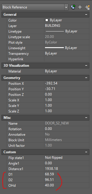

whosa Posted March 26, 2022 Share Posted March 26, 2022 (edited) Hi, I made a dynamic block with many action parameters. Two of the parameters need to be equal, but Autocad doesn't accept formulas for action parameters. D1 and D2 must be equal to OHd custom parameter Could this be done with Lisp? Something like: 1. select blocks 2. run lisp: for each block, pick OHd value (different for each block) and add it in D1 and D2 parameters. Thanks Edited March 26, 2022 by whosa Quote Link to comment Share on other sites More sharing options...

Tharwat Posted March 27, 2022 Share Posted March 27, 2022 (edited) 11 hours ago, whosa said: Many thanks. I tried it but i get this error: Select attributed blocks to replace D1 & D2 with OHd valye : Select objects: 0 found Select objects: 0 found, 0 total There was no error but the goal of the program was targeting attributed blocks and not dynamic blocks with parameters and that was my misunderstanding with your request. Anyway, please try the following : (defun c:Test (/ int sel ent blk val prp prs rtn lst) ;; Tharwat - Date: 27.Mar.2022 ;; (and (princ "\nSelect Dynamic blocks to replace D1 & D2 with OHd value : ") (setq lst '("OHd" "D1" "D2") int -1 sel (ssget '((0 . "INSERT")))) (while (setq int (1+ int) ent (ssname sel int)) (and (= (vla-get-IsDynamicBlock (setq blk (vlax-ename->vla-object ent))) :vlax-true) (setq prs (vlax-invoke blk 'getdynamicBlockproperties)) (mapcar '(lambda (u) (and (vl-position (setq prp (vla-get-propertyname u)) lst) (or (and (= prp (car lst)) (setq val (vlax-get u 'Value))) (setq rtn (cons u rtn)) ) ) ) prs) val rtn (mapcar '(lambda (u) (vlax-put u 'Value val)) rtn) (setq rtn nil) ) ) ) (princ) ) (vl-load-com) Edited March 27, 2022 by Tharwat 1 Quote Link to comment Share on other sites More sharing options...

whosa Posted March 27, 2022 Author Share Posted March 27, 2022 3 hours ago, Tharwat said: There was no error but the goal of the program was targeting attributed blocks and not dynamic blocks with parameters and that was my misunderstanding with your request. Anyway, please try the following : (defun c:Test (/ int sel ent blk val prp prs rtn lst) ;; Tharwat - Date: 27.Mar.2022 ;; (and (princ "\nSelect Dynamic blocks to replace D1 & D2 with OHd value : ") (setq lst '("OHd" "D1" "D2") int -1 sel (ssget '((0 . "INSERT")))) (while (setq int (1+ int) ent (ssname sel int)) (and (= (vla-get-IsDynamicBlock (setq blk (vlax-ename->vla-object ent))) :vlax-true) (setq prs (vlax-invoke blk 'getdynamicBlockproperties)) (mapcar '(lambda (u) (and (vl-position (setq prp (vla-get-propertyname u)) lst) (or (and (= prp (car lst)) (setq val (vlax-get u 'Value))) (setq rtn (cons u rtn)) ) ) ) prs) val rtn (mapcar '(lambda (u) (vlax-put u 'Value val)) rtn) (setq rtn nil) ) ) ) (princ) ) (vl-load-com) thanks, work perfect. Quote Link to comment Share on other sites More sharing options...
