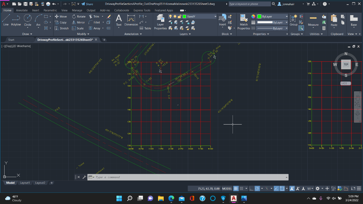

Hello,
I'm working on the Penn Foster Structural and Civil Drafting Project. I am aware the there is a feed that talks on this. They do not speak on what I lost on.
The instructions for how to make a profile are:
DRAWING HIGHWAY PROFILES
Follow these steps to create a highway profile:
1. Create a grid that's a little longer than your highway centerline. If your profile will be drawn at a different scale (for instance, not actual size), it's best to draw the profile at scale rather than using actual measurements. It may be helpful to set and lock the viewport in the Layout tab as 1:1 and draw the profile within the viewport Model space so you can see the space you have available on the drawing sheet.
2. Plot the highway centerline along the grid, making sure to use the right scale both horizontally and vertically.
3. Label the locations of any features, such as stationing, culverts, utilities, and so on on the profile. Where appropriate, add these features to the profile (for example, for a culvert under the highway.)
And the project directions are:
For Section A, use a vertical scale of 1″ = 10′ and a horizontal scale of 1″ = 60′. Show the stationing, however, in 50-foot increments. Thus, when plotting the drawing, the distance between Station 0 + 00 and Station 0 + 50 will be 5⁄6 of an inch.
Label the southern edge of the driveway and the northern edge of the driveway.
Use the layer Details with the appropriate hatch patterns to show the cut and/or fill in the cross-section.
Technically, the culvert should also be in this section. However, it's clearer to show the culvert in the driveway profile. Showing it in Section A might be more confusing than helpful. Thus, it's best to omit that feature of the building from Section A.
I'm not sure if I'm supposed to literally line the driveway up with the graph or just mathematically. I also don't understand if this is the correct scale.
Can someone please tell me if this is correct?
Edited by JonnaMcSki
No, you do not line the driveway up to the grid.  If you did that the features in the plan view of the driveway would not fall in their correct locations in the grid.  It's all based on the stationing.  Example: if you have a culvert located at station 3+87.5 in the plan view then it must be drawn at the same location in the grid and at the proper elevation.
Note: It would help immensely if you asked your question in a thread that actually covers this particular P-F project.  I have mentioned this to you in the past.
Edited by ReMark
Thank you for answering
Note: I did ask my question in that thread and no one responded.  please go look
So, do I not line it up at all? or is the alignment just wrong?

You can line up station 0+00 in the plan view of the driveway with 0+00 in the grid and that's all.  Everything after that is based upon the stationing.  Did you not follow what I wrote in my example previously?  When it comes to plotting features shown in the plan view, in the profile grid, treat the plan view as if it were a straight line.

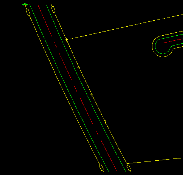

However its the creating of the roads. Here are the instructions:
once you've drawn the existing contour lines, you can draw the existing roads.
The main road is Cedar Park Drive.
It's at the bottom of a hillside. The centerline radius of Cedar Park Drive is 7115.37′, and the centerpoint is located at 528257.05,47668.89. The distance from the centerline to the curb on each side is 20′, and the distance from the centerline to the right of way on each side is 40′.
  1. Create and use a layer named Center (color red, linetype center), a layer named Curb (color green, linetype continuous), and a layer named Row (color yellow, linetype continuous) when drawing Cedar Park Drive.
  2. Label the road using style ROMANS-8 with ROMANS font, a height of 8″, and a width of 1.00. Put the text on layer Text-Large (color green, linetype continuous). Place the text somewhere in the road so it doesn't interfere with other information. Label the right of way using style ROMANS-6 with ROMANS font, a height of 6″, and a width of 0.8. Put the text on layer Text-Med (color yellow, linetype continuous). Place the text—ROW—on each right-of-way line, and break the line around the text.
  3. The new residence address will be 562 Ocean Avenue.
  4. The centerline of Ocean Avenue is 40.58 feet south of the northeast corner of the surveyed area. The centerline has a bearing of S 77°44′17″ W and extends a distance of 407.11 feet from the eastern edge of the surveyed area. At that point, Ocean Avenue ends in a cul-de-sac. The distance from the centerline to the curb on each side is 15 feet, and the distance from the centerline to the right of way on each side is 25 feet.
  5. The exact center of the cul-de-sac is 10.00′ south of the western end of the avenue's centerline: coordinates 522116.3, 44758.19. The right of way circles around the center of the cul-de-sac with a radius of 35 feet, and the curb circles around with a radius of 25 feet from the center of the cul-de-sac. The cul-de-sac right of way connects with the avenue's southern right of way to form a fillet with a radius of 10 feet. The cul-de-sac curb connects with the avenue's southern curb to form a fillet with a radius of 20 feet.
  6. Use the layers Center, Curb, Row, Text-Large (for the street label), and Text-Med (for the ROW label).
Can I have someone provide help with drawing this road.
Edited by VanossaRaptor
I might be able to provide some assistance.  The first thing that needs to be done is locate the center of the radius which according to the above instructions is at the coordinates 528257.05,47668.89.  The radius is given as 7115.37'.  Draw the radius and offset it to either side a distance of 20' then trim as necessary.  Cedar Park Lane is the road to the left in the image below.  In this image the centerline appears in red while the 20' offsets (edge of road) appear in green.  The yellow lines define the Right-of-Way and are offset 40' to either side of the centerline.  Note: with a centerline radius of over 7,000 feet the road will appear to be almost, but not quite, straight.
