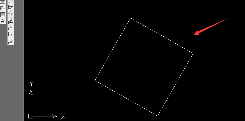

Hello everyone, I use Lee Mac's bounding box code, it always gets the primitive bounding with a positive angle, unfortunately, after rotating the primitive angle, or the bounding box is positive, which is not what I want , How can I get the minimum bounding box of the selection set, even if its angle is arbitrary, instead of getting a positive bounding box?20220316.thumb.png.51d32b93b274a66e5cf13e50005aa856.png
