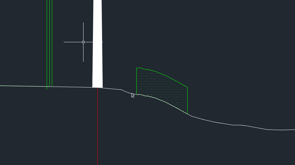

Hello, can anyone help me in finding or makind a autocad lisp to draw vegetation and paths in profile?
i attach a image so you can understand what i need, choosing the star and end of the polyline it makes a offset of the profile with a distance that the lisp asks. and connect vertical lines.
Can it be done with a lisp? thanks in advance it will be very helpful , because i have a powerline project to make and that is a long time consuption.... best regards

Then all it takes is draw 2 lines the right length starting at the 2 points, offset the profile and chamfer that (with a distance of 0) to the vertical lines, perhaps to copy your profile and chamfer the copy to the vertical lines to create a closed polyline for example to hatch later.
So yes it is very possible to do this... but what is our starting point, where have you got and where are you stuck?

Thanks for the feedback, i have not experience in programming lisps but i will try, i need this because in a long profile it is a very time consuming doing this. best regards
