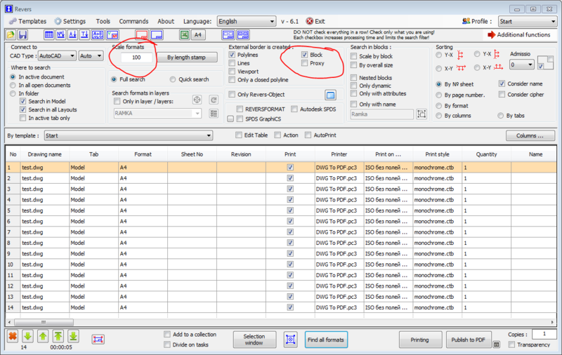

Why not go the next step for me layouts with all different size sheets and orientation one click on a menu and all the pdf's come out correct in one go no user interaction. Done for a client.
  • Thanks 2
1 hour ago, jim78b said:
i never mean it, thanks😃
So that there is a choice of different creation options and methods:
Here you need to click 3 buttons to create Layouts - AutoViewport
even this is very helpfullthanks!!!
