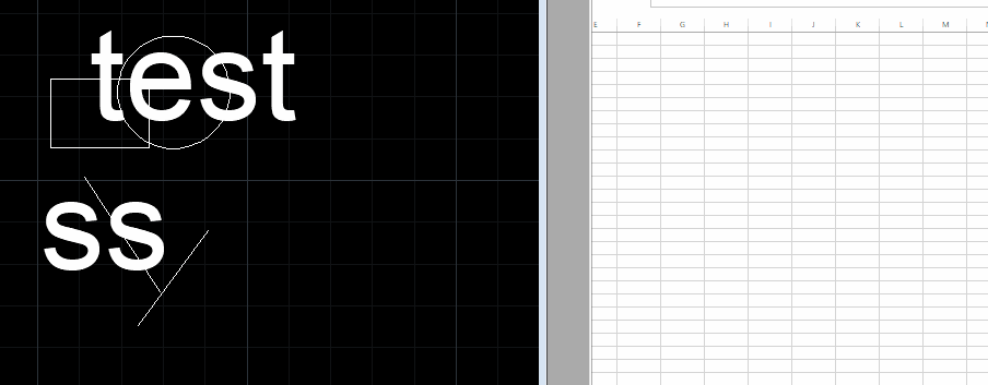

2 hours ago, ekko said:
I tried it, it is not the function I want, can you teach me how to import the screenshot from CAD to excel
1. if you want just how to input wmf to excel.
my routine makes .wmf image file in .dwg file's directory. just insert like png or jpeg same way.
2. if you want just image with fixed size.
jpgout or pngout make same pixel size with your autocad drawing window. (not coordinates or size in drawing, just window box size you can see)
so, this is Cheating way. I like cheating
When specifying pt1 and pt2, you do not enter pixels. just picking coordinates.
so, width of the output image value is entered
height of the output image is automatically adjusted according to the xy ratio of pt1 and pt2.
Because it is affected by the window size, it worked normally at a width of 1500 or less in an environment of 1920x1080.
and, In my environment
-16px is insufficient in width
-55px is insufficient in height.
it's probably because of the scrollbars and titles of the drawing window.
You can test it in your own environment and change this number.

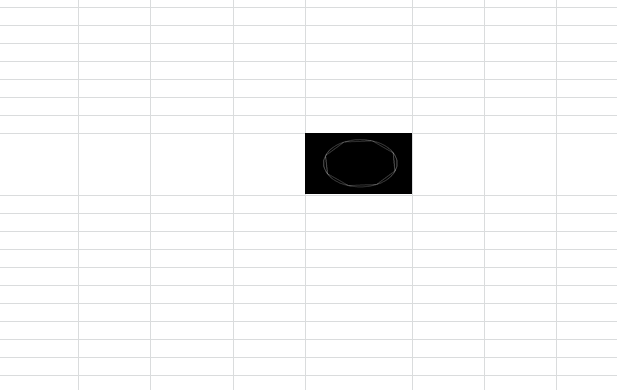

Thank you for your help my bro, but it doesn't seem to work, my requirement is to take a screenshot in the CAD selection area --> import the screenshot into the excel sheet, of course, I don't want the screenshot to be too big. Specifying the area screenshot is just the first step, please help me if you can, as it is beyond my programming skills, thanks
ekk 1st the "A4 400 dpi" just do PLOT "plot to web jpg" and look at all the sizes available, use a suitable one
Ok for paste to excel different method I would do something like this very simple
(alert "Pick window for clip") you can move the alert window out of the way,
use window+shift+S on keyboard this starts snipping tool. select screen area.
Click ok on alert
Go to excel, pick cell, paste
Ok tricky bit could know cell address, get application to excel and use pasteclip to cell.
Not tested a lot of time to code compared to seconds to snip and paste.

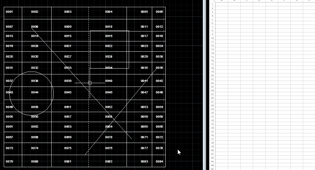

I found a piece of code on the Internet, this is just an example, it doesn't seem to be complete, and an error is reported when debugging, can you use this code to modify it to meet expectations
https://www.theswamp.org/index.php?topic=52702.0
I found this code. in MSWORD, paste new screenshot continuously in 1 word file.
automatic doc file making by same name. or open that if it existed.
I think do same thing in MSEXCEL is work.

open empty excel file. before run this lisp.
paste in selected cell, but size is 1:1 scale, not fit to cell

ok, I study that, below is correct I think.
  (setq
    shape (vlax-get (vlax-get-property app 'selection) 'shapeRange)
vlax-get > vlax-get-property
activeworkbook0 > app (excel application)
and add error control
when cancel the process (space-bar or esc), osmode recovered
and add option png,
ssw - wmf out
ssp - png out
if you want change width of picture.
(setq width_you_want 30) ;edit this 30 value. in ssw and ssp both.
                                               this is same with width property in excel. (30cm)

  (setq input_width 1200) ;input fixed value for simplify
  (setq input_height (atoi (rtos (* input_width xy_ratio) 2 0)) )
  (setq input_width (+ input_width 16)) ; 16 is my environment gap of window size & image size. shoud be edited
  (setq input_height (+ input_height 55)) ; 45 is my environment gap of window size & image size. shoud be edited
  (if (= (findfile ph) nil)
        (princ "\nCreate new image file ")
        (vl-file-delete ph)
        (princ "\nReplace image file")
  (if (setq ss (ssget "c" pt1 pt2)) ;'((0 . "lwpolyline,line,ARC"))))
      (command "_Zoom" "w" pt1 pt2 "")
      (vla-put-height acdoc input_height)  ;edited line
      (vla-put-width acdoc input_width)  ;edited line
      (command "_pngout" ph "all" "") ;edited line for all entities, replace with (command "_pngout" ph ss "")
  (command "_Zoom" "p")
  (vla-put-windowstate acdoc 3)  ;edited line
  (command "_syswindows" "c")  ;edited line
  (setvar "osmode" ods)
  (princ "\ndone.")
  (princ (strcat "\nimage output path:" ph))
 (setq app (vlax-get-or-create-object "Excel.Application"))
 (vla-put-visible app :vlax-true)
 (vlax-put-property app 'ScreenUpdating :vlax-true)
  (setq	activeworkbook0
	 (vlax-get-property app 'ActiveWorkbook)
  (setq	activesheet0
	 (vlax-get-property activeworkbook0 'ActiveSheet)
  (setq cells0 (vlax-get-property activesheet0 'cells))
  (setq pic (vlax-get activesheet0 'Pictures))	;Pictures object
  (setq picture (vlax-invoke pic 'insert ph)) ;execute insert image
  (vlax-invoke picture 'select)		;select this image
  (setq
  )					;picture object
  ;(vlax-put shape 'LockAspectRatio 0)	;Release aspect lock
  ;(vlax-put shape 'Height (/ input_height 3))
					;Set the height of the image (pixels)
  (setq width_you_want 30) ;edit this 30 value. this is same with width property in excel.
  (vlax-put shape 'width (* 28.3464566929 width_you_want)) ;Set the width of the image (pixels)
  ;(vlax-invoke shape 'IncrementTop input_height)
					;Set the image downshift distance (pixels)
  ;(vlax-invoke shape 'IncrementLeft input_width)
					;Set the image right shift distance (pixels)
; closing..
 ;(vlax-invoke-method app 'Saveas  (strcat (getvar "dwgprefix") (vl-filename-base (getvar "dwgname")) ".xlsx"))
 ;(vlax-invoke-method app 'Close)
 ;(vlax-invoke-method app 'Quit)
  (LM:endundo (LM:acdoc))
  (setvar "cmdecho" 1)
;; Active Document  -  Lee Mac
;; Returns the VLA Active Document Object
(defun LM:acdoc nil
    (eval (list 'defun 'LM:acdoc 'nil (vla-get-activedocument (vlax-get-acad-object))))
    (LM:acdoc)
;; Start Undo  -  Lee Mac
;; Opens an Undo Group.
(defun LM:startundo ( doc )
    (LM:endundo doc)
    (vla-startundomark doc)
;; End Undo  -  Lee Mac
;; Closes an Undo Group.
(defun LM:endundo ( doc )
    (while (= 8 (logand 8 (getvar 'undoctl)))
        (vla-endundomark doc)
(princ "\n loading complete")
The program is running very well, exactly as I expected, obviously you are a selfless person, I wish you good health and a happy life my brother, thank you very much for your help, salute to you
2 hours ago, exceed said:
  (setq
(vlax-put-property cells0 'item 1 1 picture )
May I ask if I can insert a picture into a specific row or column of cells, (vlax-put-property cells0 'item 1 1 picture ) similar to this, unfortunately, I don't know why, this method will report an error.
(vlax-put-property cells0 'item y x "textstring")
I think, this works with text string or text string variable only.
Because Excel treats images as special objects separate from cell values
so, the lisp code you get in internet. also shifting down images and shifting right images in units of pixels, not cells.
of course, there is a way to create a function using Excel's vba macro and insert an image into a cell,
but I don't think it's a good way to put a macro in every target Excel file and change it to an .xlsm file for all work.
or if you want use that sentence, can approach like this way
making image to not replace. (with loop and indexing name of image)
='<img src=""full path of image" "width=100 height=100 ><table>
and copy to clipboard and paste special to put unicode format texts.
i success to put them all. but I failed to load image.
it's not good way also. because images is not in excel.
so, I thnk below is better and different way to approach
make loop like this
(defun c:ssw2 (/ index r c)
  (setq index 0)
  (setq r 1)
  (setq c 1)
  (while
     (c:ssw)
     (setq r (+ r 1))
     (setq index (+ index 1))
and add this
  (setq addr (strcat (chr (+ 64 c)) (itoa r) ":" (chr (+ (ascii (chr (+ 64 c))) (1- 1))) (itoa (+ r (1- 1)))))
  (setq rng (vlax-get-property activesheet0 'Range addr))
  (vlax-invoke Rng 'Select)
in front of this
because this routine is paste in current selected cell in excel.
so, this additional code will change selected cell.
but this is start from column 1, row 1
it will be change with this, paste it in front of ssw2
(setq ExcelApp (vl-catch-all-apply
	       (function (lambda ()(vlax-get-or-create-object "Excel.Application")))))
(if (vl-catch-all-error-p
      (setq Wbk
	     (vl-catch-all-apply
			   (vlax-get-property ExcelApp "ActiveWorkBook"))))))
    (alert "open Excel before you run this")
    (exit)
    (*error* nil)
(setq Sht
       (vl-catch-all-apply
		     (vlax-get-property ExcelApp "ActiveSheet")))))
(vlax-put-property ExcelApp 'visible :vlax-true)
(vlax-put-property ExcelApp 'ScreenUpdating :vlax-true)
(vlax-put-property ExcelApp 'DisplayAlerts :vlax-false)
(princ "\n go to excel then select cell to paste picture")
(if (not (vl-catch-all-error-p
	   (setq Rng
		  (vl-catch-all-apply
				(vlax-variant-value
				  (vlax-invoke-method
				    (vlax-get-property Wbk 'Application)
				    'Inputbox
				    "select 1 cell you put in : "
				    "ssw"
				    nil
				    nil
				    nil
				    nil
				    nil
				    8))))))))
    (vlax-put-property ExcelApp 'DisplayAlerts :vlax-true)
    (setq r (vlax-get-property Rng 'row))
    (setq c (vlax-get-property Rng 'column))
ExcelApp and Wbk is same with in ssw's. you can optimize this.
and then select entire row. and change row height
like this
; instant screenshot for excel - 2022.03.07 exceed
; open target excel sheet before run this lisp.
; - command
; ssw - screenshot .wmf to selected cell in excel
; ssp - screenshot .png to selected cell in excel
; ssw2 - screenshot .wmf to excel continuously from selected cell
; ssp2 - screenshot .png to excel continuously from selected cell
; note - If the height is much longer than the width, a wider range than the set width can be seen.
;          Due to a limitation in Excel, the maximum cell height is 409.5.
(vl-load-com)
(defun c:ssw (/ *error* ods acdoc pt1 pt2 ph x_dist_selection y_dist_selection xy_ratio input_width input_height ss app activeworkbook0 activesheet0 cells0 shape pic picture width_you_want)
  (setvar "cmdecho" 0)
  (setq ods (getvar "osmode"))
  (setvar "osmode" 0)
  (LM:startundo (LM:acdoc))
    (defun *error* ( msg )
        (if (not (wcmatch (strcase msg t) "*break,*cancel*,*exit*"))
            (princ (strcat "\n Error: " msg))
  (princ "\nPlease open the excel sheet before running.\nInserts the selected area screenshot into the selected cell in Excel as a wmf image. (background transparent)")
  (ex:ESMAKE)
  (setq acdoc (vla-get-activedocument (vlax-get-acad-object)))
  (setq    pt1 (getpoint "\nSelect the first point:")
            pt2 (getcorner pt1 "\nselect the second point:")
            ph  (strcat (getvar "dwgprefix") (vl-filename-base (getvar "dwgname")) "-" (rtos (getvar 'cdate) 2 10) ".wmf") ;edited line
  (setq x_dist_selection (abs (- (car pt1) (car pt2)) )) ;edited line
  (setq y_dist_selection (abs (- (cadr pt1) (cadr pt2)) )) ;edited line
  (setq xy_ratio (/ y_dist_selection x_dist_selection)) ;edited line
  (setq input_width 1000) ;input fixed value for simplify
  (setq input_height (+ input_height 55)) ; 55 is my environment gap of window size & image size. shoud be edited
        (vl-file-delete ph)
      (command "_wmfout" ph "all" "") ;edited line for all entities, replace with (command "_wmfout" ph ss "")
  (princ "\ndone.")
  (setq	activesheet0
  (setq
  )					;picture object
; closing..
(defun c:ssp (/ *error* ods acdoc pt1 pt2 ph x_dist_selection y_dist_selection xy_ratio input_width input_height ss app activeworkbook0 activesheet0 cells0 shape pic picture width_you_want )
  (setvar "osmode" 0)
  (princ "\nPlease open the excel sheet before running.\nInserts the selected area screenshot into the selected cell in Excel as a png image.")
  (ex:ESMAKE)
            ph  (strcat (getvar "dwgprefix") (vl-filename-base (getvar "dwgname")) "-" (rtos (getvar 'cdate) 2 10) ".png") ;edited line
        (vl-file-delete ph)
  (princ "\ndone.")
  (setq	activesheet0
  (setq
  )					;picture object
; closing..
(defun c:ssw2 (/ *error* addr selectedcolumns columnwidthtofit xlrows xlcolumns rowheighttofit selectedrows app index r c rng activeworkbook0 activesheet0 ods acdoc pt1 pt2 ph x_dist_selection y_dist_selection xy_ratio input_width input_height ss cells0 shape pic picture width_you_want)
  (setvar "osmode" 0)
