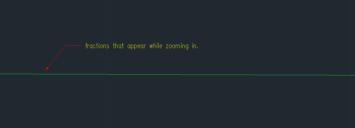

shokoufeh Posted February 27, 2022 Share Posted February 27, 2022 Hi every one. I have a question. I searched a lot but couldn't find the answer. I use Auto cad 2018. In my computer, while I zoom in, the lines that are not vertical or horizontal get some fraction in them; so I can find oriented lines easily. It is important for me that every vertical or horizontal lines be completely straight. So by zooming in (by scrolling the mouse), i can easily find the lines which are even 0.001 mm oriented. As I said, this is found by the fraction that appear in line while zooming in. now the question is: I have another computer whit exactly the same graphic and CPU and the same auto cad version. But zooming in, does not show the fraction in lines (if the line is a little oriented). I am curious to know what the problem is and why this fractions do not appear in the second computer? I attach a picture that shows the fraction in line that I mean. Thank you. Quote Link to comment Share on other sites More sharing options...

shokoufeh Posted March 6, 2022 Author Share Posted March 6, 2022 On 3/4/2022 at 10:38 PM, Dana W said: Look at your GRAPHICSCONFIG command. Do both AutoCAD programs have line smoothness set the same? Thank you very much. this solution worked for me. Quote Link to comment Share on other sites More sharing options...
SLW210 Posted March 7, 2022 Share Posted March 7, 2022 Are my posts not showing up? One of the first solutions in the link I posted. Quote Solution: Do one or more of the following to adjust the line display in AutoCAD: Install the latest updates for AutoCAD (see Install Updates, Add-ons, and Enhancements). On the command line in AutoCAD, enter GRAPHICSCONFIG and verify that the correct video card is being used (see AutoCAD uses the wrong graphics card). In the same Graphics Performance window, turn off Smooth line display and/or High Quality Geometry. Alternatively, on the command line enter LINESMOOTHING and HQGEOM and set the values to OFF or 0 (zero). Quote Link to comment Share on other sites More sharing options...
