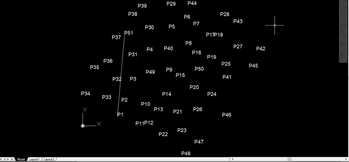

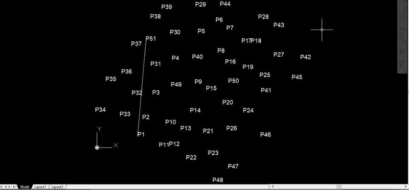

Tharwat Posted February 26, 2022 Posted February 26, 2022 Your texts have to be single texts to be able to select them and besides that they should end with digit. (defun c:Test (/ int sel ent get lst) ;; Tharwat - Date: 26.Feb.2022 ;; (and (princ "\nSelect single texts : ") (setq int -1 sel (ssget '((0 . "TEXT") (1 . "*#")))) (or (< 1 (sslength sel)) (alert "Must select two texts at least to continue <!>") ) (while (setq int (1+ int) ent (ssname sel int)) (setq get (entget ent) lst (cons (list (atoi (substr (cdr (assoc 1 get)) 2)) (cdr (assoc 10 get)) ) lst ) ) ) (entmake (list '(0 . "LINE") (cons 10 (cadar (setq lst (vl-sort lst '(lambda (j k) (< (car j) (car k))))))) (cons 11 (cadar (reverse lst))) ) ) ) (princ) ) (vl-load-com) 3 Quote
Tharwat Posted February 26, 2022 Posted February 26, 2022 23 minutes ago, cepsoe12 said: it worked, thank you You're welcome anytime. Quote
