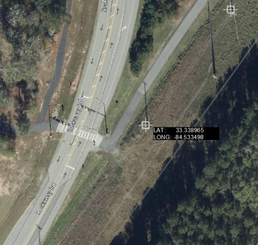

Hello everybody,
Currently using Cad 2022 Map 3D,
I have around three to four hundred GPS points for existing poles and probably more coming, I'm looking for a way to display their respective Lat and Long on the model space on Mtext format like the sample below, any help would be greatly appreciated. I know that your time is valuable.
Thank you

Bigail,
Thank you for your help, but I maybe not explaining myself correctly.
I get GPS points from a Trimble system that get converted to CAD, during the process of the gps points they get Geolocated correctly on their corresponding places.
I take does points and place them in the drawing, I'm trying to find a way to display the coordinates in the drawing of each point right next to the point instead of manually entering each number. I'm not just trying to find a way to look up the number, I want to place the coordinates in the drawing just like the image provided.
I don't have Civil3D.
See the attached files, the cad file is how I get the point in the drawing and the template has a geographic location as well, if I didn't the gps point would not land in the correct locations.
Thank you.
Thank you Bigal, this is good enough.
I won't have to type it just clik.
Thanks for your time really appreciated. ðŸ˜€
