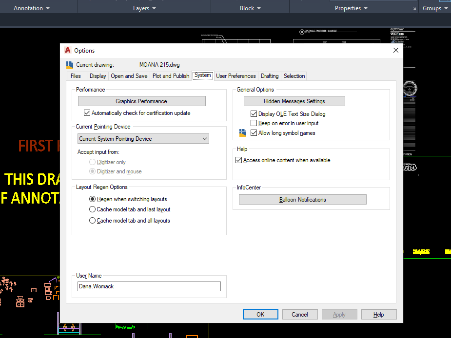

Dana W Posted February 25, 2022 Share Posted February 25, 2022 (edited) Try this. Left column, Layout Regen Options. Edited February 25, 2022 by Dana W Quote Link to comment Share on other sites More sharing options...
Fikriye Posted September 21, 2022 Share Posted September 21, 2022 (edited) Merhaba ,bu işe yarıyor,ama mevcut tasarımın "layout" kısmında değişiklik yapmadı. Bu yüzden aşağıdaki ayarı yaptıktan sonra tasarımı yeni bir sayfaya aldım. Modelde yaptığım her değişiklik layout a yansıyor artık.Teşekkürler Dana W Quote Hi, this works, but it didn't change the "layout" part of the current design. That's why I got the design on a new page after I made the following setting. Every change I make in the model is now reflected in the layout. Thanks Dana W On 2/25/2022 at 2:51 PM, Dana W said: Edited September 21, 2022 by SLW210 Translation Quote Link to comment Share on other sites More sharing options...
