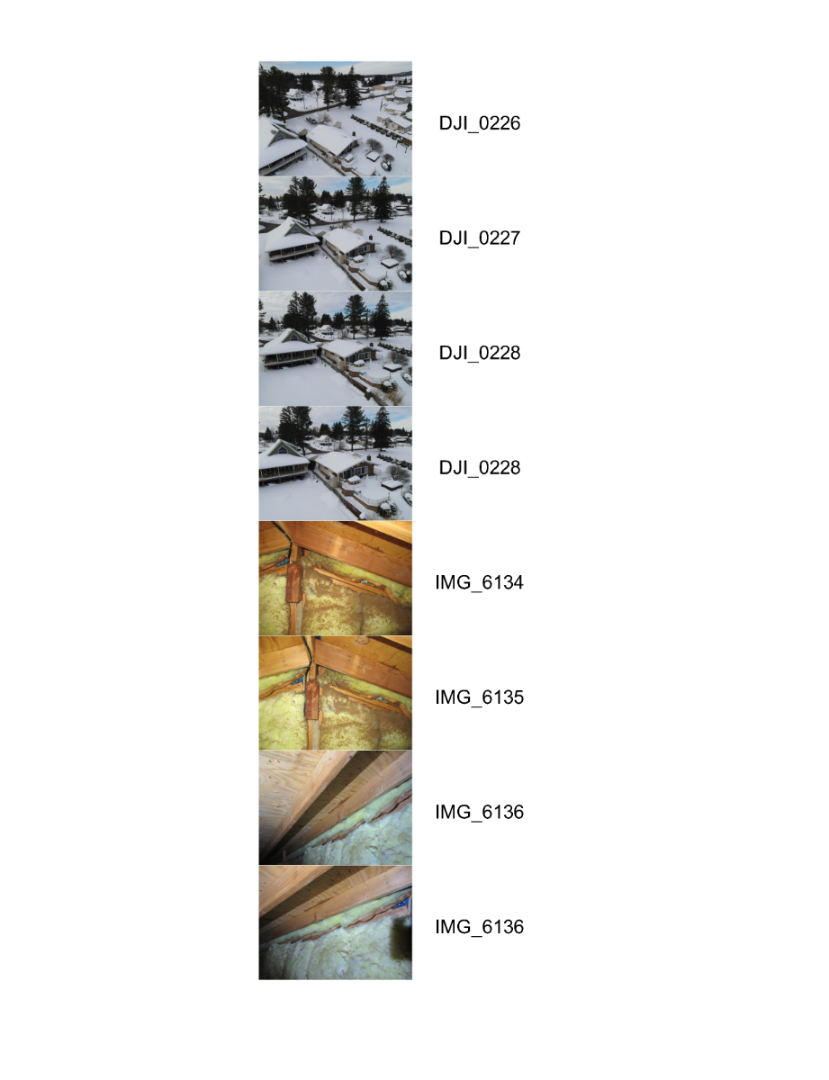

TonyBaloni Posted February 19, 2022 Share Posted February 19, 2022 This nice little subroutine below by Alan Thompson places multiple images on AutoCAD. And it works beautifully. But what I also need to do is to add the name of the file next to each image (see the attached picture). Any ideas where to start? I am very new to AutoLISP. Thank you Tony (defun c:ImageIn (/ lst a b fin) ;; Alan J. Thompson, 05.10.10 ;; DosLib required (vl-load-com) (if (setq lst (dos_getfilem "Select images to insert:" (getvar "dwgprefix") "")) ((lambda (layers) (foreach file (vl-sort (cdr lst) (function >)) (if fin (progn (vla-GetBoundingBox (car fin) 'a 'b) (setq b (vlax-safearray->list b)) (vl-cmdf "_.image" "_attach" (strcat (car lst) file) (list 0. (1+ (cadr b))) "" "") ) (vl-cmdf "_.image" "_attach" (strcat (car lst) file) '(0. 0. 0.) "" "") ) (vla-put-layer (car (setq fin (cons (vlax-ename->vla-object (entlast)) fin))) (vla-get-name (vla-add layers (vl-filename-base file))) ) ) ) (vla-get-layers (cond (*AcadDoc*) ((setq *AcadDoc* (vla-get-activedocument (vlax-get-acad-object)))) ) ) ) ) (princ) ) Quote Link to comment Share on other sites More sharing options...
TonyBaloni Posted February 19, 2022 Author Share Posted February 19, 2022 I did find this online (see below)....but it returns "error: ADS request error" Maybe I can use this after inserting the images...to put the name of the image next to it. If anyone out there knows how to fix it (?) (defun c:ImageNameLabel (/ s h i e) (if (and (setq s (ssget '((0 . "IMAGE")))) (setq h (getvar 'textsize)) ) (repeat (setq i (sslength s)) (setq e (ssname s (setq i (1- i)))) (entmake (list (cons 0 "TEXT") (assoc 10 (entget e)) (cons 40 h) (cons 1 (getpropertyvalue e "ImageName")))))) (princ) ) Quote Link to comment Share on other sites More sharing options...

Tharwat Posted February 19, 2022 Share Posted February 19, 2022 You can change the value of the variable 'g' in the following routine to adjust the gap distance between image & text. (defun c:test (/ s h i e g l r) (if (and (setq s (ssget '((0 . "IMAGE")))) (setq h (getvar 'textsize)) (setq g (/ h 2.0)) ) (repeat (setq i (sslength s)) (setq e (ssname s (setq i (1- i)))) (vla-getboundingbox (vlax-ename->vla-object e) 'l 'r) (setq l (vlax-safearray->list l) r (vlax-safearray->list r) ) (and l r (entmake (list (cons 0 "TEXT") (cons 10 (polar (mapcar '(lambda (j k) (/ (+ j k) 2.0)) l r) 0.0 (+ g (/ (distance l (list (car r) (cadr l) 0.0)))) ) ) (cons 40 h) (cons 1 (getpropertyvalue e "ImageName")) ) ) ) ) ) (princ) ) Quote Link to comment Share on other sites More sharing options...

Tharwat Posted February 19, 2022 Share Posted February 19, 2022 (defun c:test (/ s h i e g l r) (if (and (setq s (ssget '((0 . "IMAGE")))) (setq h (getvar 'textsize)) (setq g (/ h 2.0)) ) (repeat (setq i (sslength s)) (setq e (ssname s (setq i (1- i)))) (vla-getboundingbox (vlax-ename->vla-object e) 'l 'r) (setq l (vlax-safearray->list l) r (vlax-safearray->list r) ) (and l r (entmake (list (cons 0 "TEXT") (cons 10 (polar (mapcar '(lambda (j k) (/ (+ j k) 2.0)) l r) 0.0 (+ g (/ (distance l (list (car r) (cadr l) 0.0)) 2.0)) ) ) (cons 40 h) (cons 1 (getpropertyvalue e "ImageName")) ) ) ) ) ) (princ) ) (vl-load-com) 1 Quote Link to comment Share on other sites More sharing options...

TonyBaloni Posted February 20, 2022 Author Share Posted February 20, 2022 "test.lsp" works okay with AutoCAD 2021 but not with 2014. Any ideas why 2021 but not 2014? I was hoping to stay with 2014. Otherwise all good to go with "ImageIn" (then label with "test" after sorting images) Quote Link to comment Share on other sites More sharing options...
Tharwat Posted February 20, 2022 Share Posted February 20, 2022 That's because the function getpropertyvalue was release a few years back and not up to AutoCAD 2014 , so try the following which should work on any CAD. (defun c:test (/ s h i e g l r) (if (and (setq s (ssget '((0 . "IMAGE")))) (setq h (getvar 'textsize)) (setq g (/ h 2.0)) ) (repeat (setq i (sslength s)) (setq e (vlax-ename->vla-object (ssname s (setq i (1- i))))) (vla-getboundingbox e 'l 'r) (setq l (vlax-safearray->list l) r (vlax-safearray->list r) ) (and l r (entmake (list (cons 0 "TEXT") (cons 10 (polar (mapcar '(lambda (j k) (/ (+ j k) 2.0)) l r) 0.0 (+ g (/ (distance l (list (car r) (cadr l) 0.0)) 2.0)) ) ) (cons 40 h) (cons 1 (vla-get-name e)) ) ) ) ) ) (princ) ) (vl-load-com) Quote Link to comment Share on other sites More sharing options...

TonyBaloni Posted February 20, 2022 Author Share Posted February 20, 2022 WOW that was awesome! Thank you So now I'll use "ImageIn.lsp" (as was written by Alan Thompson) to load multiple pictures into AutoCAD 2014. Then, after using AutoCAD to sort the pictures, I can label them with "test.lsp". "imageIn.lsp" does create a new layer for each picture loaded, and I don't need that...but I can live with it...unless someone knows how to turn that off easily. Again, thank you. 1 Quote Link to comment Share on other sites More sharing options...
