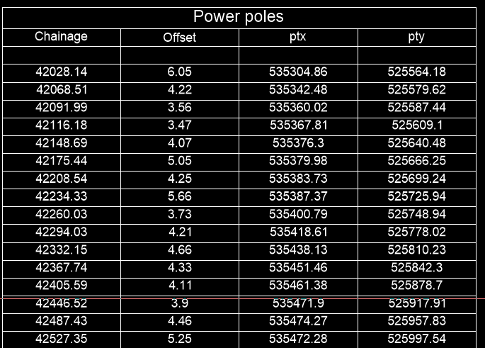

BIGAL Posted March 10, 2022 Share Posted March 10, 2022 Ok sounds like your not understanding what it is asking for re your sample dwg. The code looks for blocks named beton if these dont exist it will not work. So pick a point for the table 1 click When asked select all the dwg all the blocks and the pline using say a window select multi goes is ok Zoom in and pick the pline make sure get pline needs a multi zoom in using mouse Enter the chainage A table should appear. Quote Link to comment Share on other sites More sharing options...
