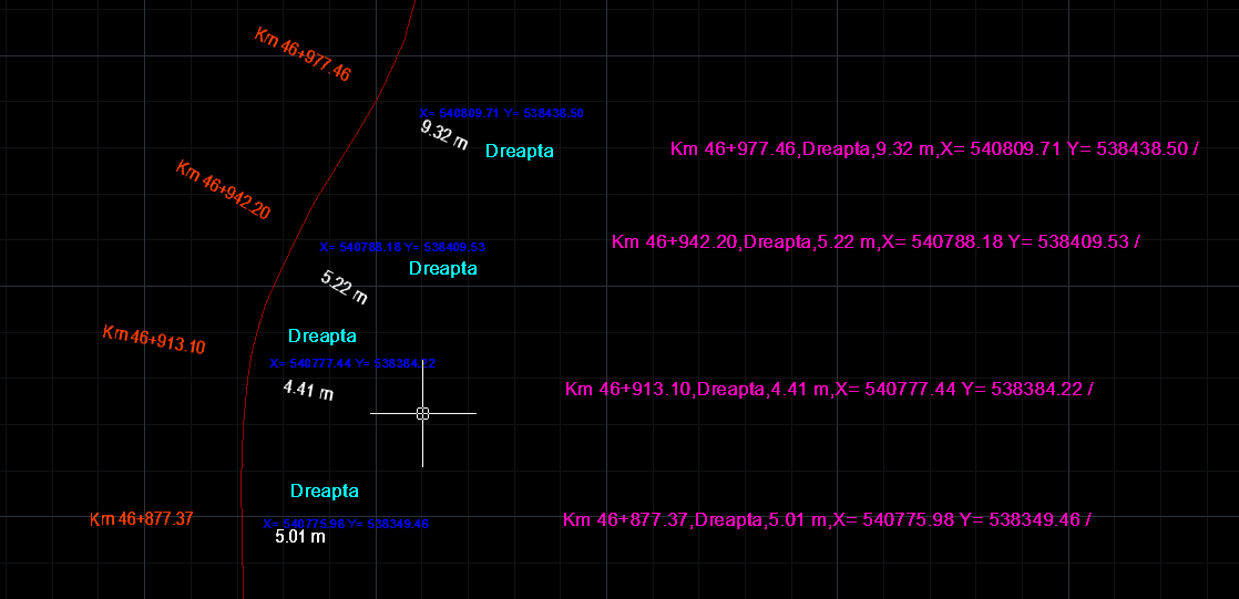

Here is an example road axis with some text data I need to copy to Calc/excel/Google sheets , then in Calc I make some automatic formatting with formulas.
The lisp file is helping me get the info in one long text, that I will Special paste in Calc/Google sheets a,d the separators will place data in cells and rows.
It's already working fine, and speeds up the process. I used to copy each text element individually and paste, but now I select the texts in a specific order, then paste all, and it saves me lot of time.
It's useful for larger projects, but still I'm working only 1KM a time , as I need to check if all elements are copied correctly.
Thanks for the support

Here are the steps I'm using:
1- I use a Chainage lisp , to automatically mark each KM on my road axis (http://www.gilesdarling.me.uk/lisproutines.shtml
2 - On plan I have some poles that will be used and sometimes I will place new poles , then II add points manually to each pole ,and using another lisp I quickly generate text with X,Y coordinates
3. Using a third lips I draw perpendicular lines, from points to the polyline
4. Now using chainage lisp from step one, I mark each perpendicular line to polyline and get chainage data for the poles
5. Using another lisp I fix chainage data from 46.368.335 to 46+368.33
6. Then I uses a function in Intellicad, that adds a Prefix to all chainage text : Km 46+368.33
7. Another lisp is used to measure and add to my plan the distance of each perpendicular line (from point to polyline) as Mtext : Distance 6.35 m , Distance 4.32 m, etc....
And I explode once this text are done so I get the "6.35 m" as a separate text from "Distance"
8. Now I add next to each point a text ,  if is on the left or right of polyline , I made a simple Lisp where I I select Left and it places the text Left, or Right and places text Right
9. And Finally Using the Concatenate lisp I merge the "KM 46+322.56" with "Left" with "6.35" with "X=52325.22 Y=44525.36" for each Pole on 1 km, I Get a text like:
Km 46+015.00,Dreapta,6.09 m,X= 540273.44 Y= 537696.42/
Km 46+046.55,Dreapta,6.32 m,X= 540286.35 Y= 537725.21/
Km 46+077.67,Stanga,6.87 m,X= 540298.90 Y= 537753.84/
Km 46+109.44,Stanga,6.40 m,X= 540310.46 Y= 537783.52/
Km 46+135.22,Dreapta,6.30 m,X= 540319.74 Y= 537807.67/
Km 46+174.90,Dreapta,6.29 m,X= 540334.02 Y= 537844.52/

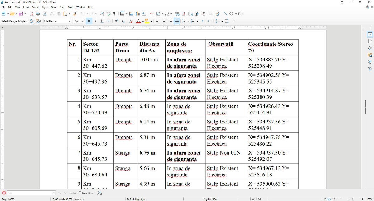

And this text goes to LibreOffice Calc,  where "," and "/" are set as separators and the text are placed in individual cells.
In Calc I add a Column in between "6.09 m" and "X Y" , with a formula that IF the distance is > 6.5 , add a text, and if is lower (<) add a different text
And I add another Column before "X,Y" with text "Existing Pole" or "New Pole 01" where 01 is always different, depending how many new poles I add
You can see attached the final table in a .doc file.

Hi BIGAL
I tested the lisp, I use Progecad 2021 (Intellicad 9.2a), and wasn't working so I added this line (vl-load-com)
And its working until I add chainage:
- I select one point on "Power poles" layer, then select similar to get all the points on the layer
- next it type command TEST
- Now message say "Pick obj" , and I select the polyline
- New message say "enter start chainage" , I add for example 42 , or 42000
- error message say "bad type argument"
I attached the dwg, there are points on "Power poles" layer, and Blocks on the "0" later
The data must be displayed on a plan, but I also need it on a doc, that why I'm copying text to LibreOffice Calc sheets, to make some further editing adding some extra columns
Regards
Romeo
demo-poles-road-axis.dwg

Sorry among the masters,
this is a lisp that just merges 4 texts.
If you always have the same layer names order, will help.
If you select a number other than 4, it exits.
command is conc2

HI there is no Dataexport but there's a table export to csv, I will have to run some test too see if its faster using the tables
thanks for the tip
