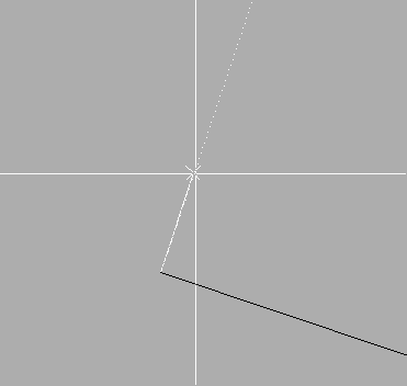

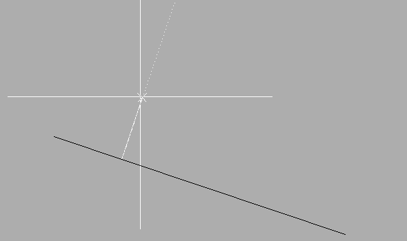

Draw a perpendicular line from another line.

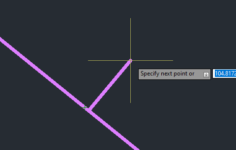

Usually there was a dotted line as per second image.

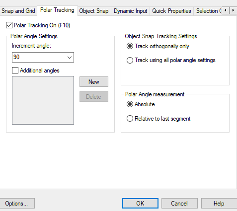

Clicking "Relative to last segment" in the options means I can use the absolute 0deg, 90deg, etc.
A new line parallel seems to work.
In your picture, the Polar Angle measurement is set to Absolute and not Relative to last segment.
Start the line command then snap perpendicular to the line you want to draw the perpendicular line to and you get the dotted line.
Yes this is because I then lose the absolute guide.

You only get the perpendicular alignment path if 'Relative to last segment' is set.

When I want to draw a line perpendicular from an existing line, I do not use the Perpendicular Object Snap. I rely on the Polar Tracking. When you pick the line, I only use Endpoint, Midpoint or nearest Object Snap. Centre Object snap refers only to circular entities.
It appears that when you pick the line using those Snaps, the line is identified as the last segment, and thus Polar tracking works relative to that line. You have to be careful that only the chosen line is in the picking box otherwise AutoCAD doesn't know which line you are choosing.
